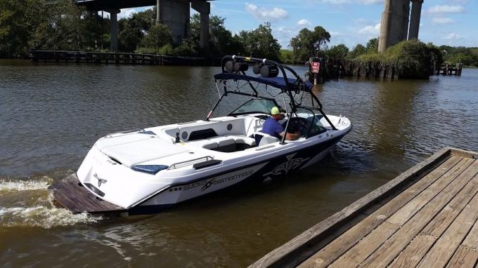

      Nice, thanks for the thorough reply Doug. Between this post, your post in the cooling thread, and the hydrophase review, you have provided a ton of useful info. The boat I am looking at doesn't have Perfect Pass and I was unaware of an alternative. Austin, Tx made is a selling point for me.
      I am familiar with CRC, we use it offshore in my profession, so I know that's good stuff.
      For now I think I will build a similar flush system out of brass fittings and run that for awhile. Diligent flushing of 10 minutes or so after each use will be very easy, as the boat will be kept in a lift in my back yard. Because of this, the trailer should also see minimal exposure to the brackish water, and can easily be pressure washed in my driveway after putting the boat in, and before storing it for my rotations home.
      Looks like we might end up with identical boats by the way...The one I am looking at isn't quite in the immaculate shape that yours is. Hopefully I can get it whipped into similar shape over the winter though. Having a mechanical/marine survey done on Wednesday to ensure everything is legit. The suspense is killing me.
