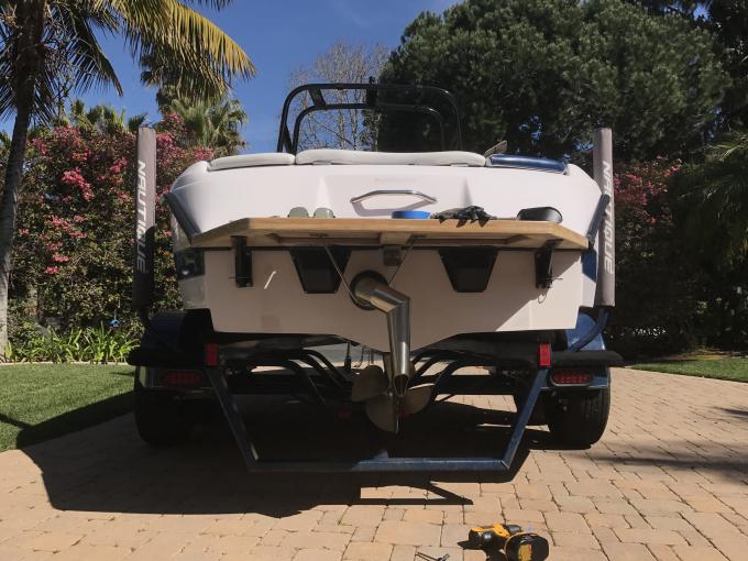

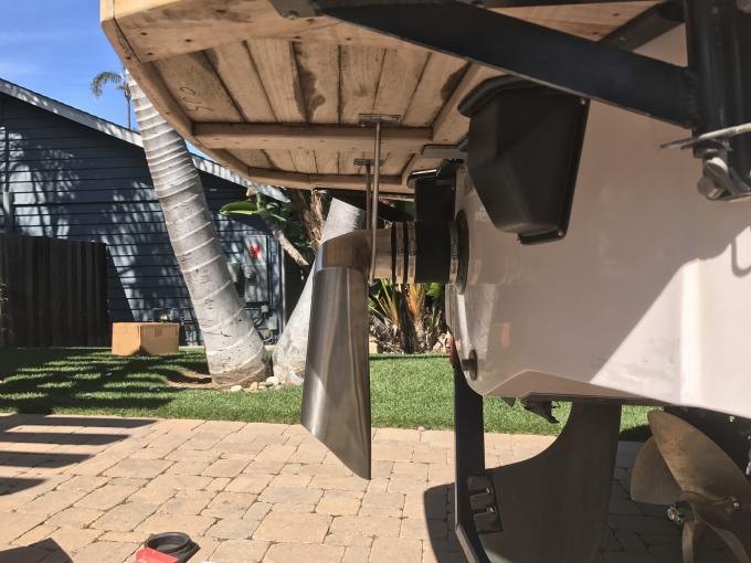

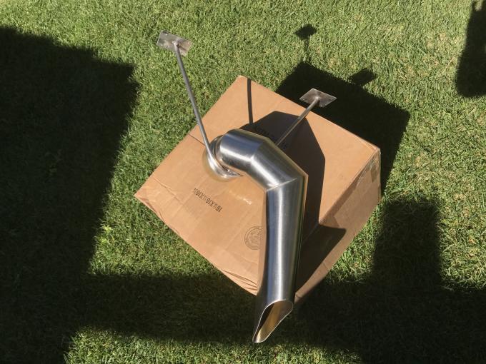

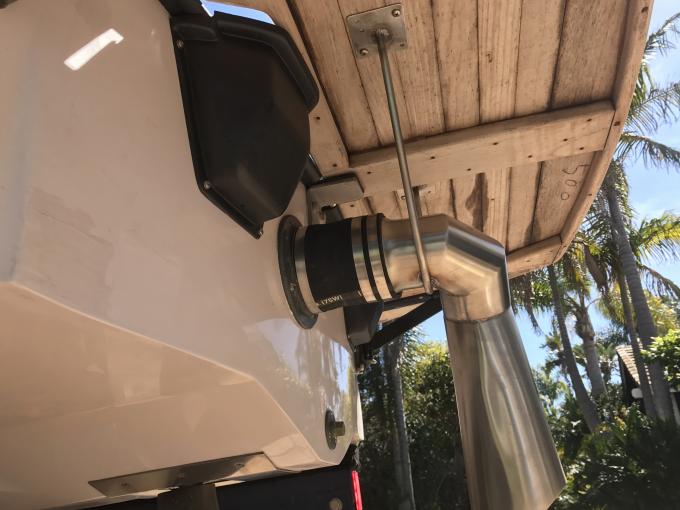

      I worked with Larry and team @ FAE to order an exhaust without their usual erector set mounting system. I fabricated my own and welded to their provided pipe. After fabricating my 3/8" stainless "strut loop" and flange mounts which screw in to the bottom of the teak platform, I TIG welded it to the FAE pipe. They shaved off $40 for leaving off their mounting hardware.
      I proposed to them a similar mounting system with threaded rod, so rod ends and a yoked flange could be used to offer adjustability vs. the erector set mounting system.
      I spent 3 or 4 hours fabricating. Hardest part was getting the curve to match the diameter of the pipe. I used a very large impact socket (2 1/4" Diameter) as a forming die and my bench vice and a larger piece of tubing to slip over the rod to aid in bending (cheater bar).
