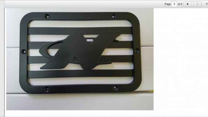

        Yes it is a rectangular vent and it will be installed just under the observer seat in the gel coated fiberglass.
        Click image for larger version  Name:	image.png Views:	2 Size:	21.2 KB ID:	508979

          Let me know how it goes. I bought two of those vents as well but haven't got around to cutting.

            That looks pretty cool. If it were my project I think I'd tape off the area with good painters tape. Hold the plate where you want it and trace the inside of the perimeter of the nautique plate onto the tape. This looks like it will be your cut line. Then I'd use a dremel with a cutoff wheel and cut just shy of your cut line that way you can use a dremel sanding drum and sand your way to the cut line and get it perfect, if that males sense.

              I have been worried about the cut given how close the screw holes are to the inside perimeter. Not much room for error but that is a good idea on cut short and sand your way in. Hadn't thought of that
