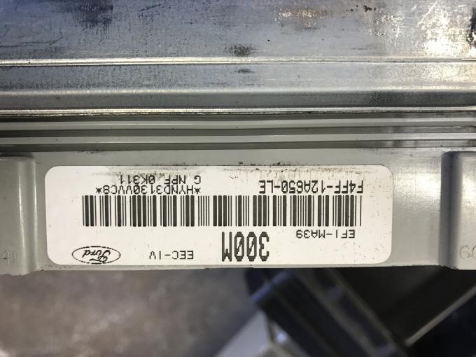

    Ah I just reread the thread and it said any eec with the same HARDWARE should work. So the fact that they both start with L means the hardware is the same between both our eecs? The B on yours and E on mine may be a reflection of the fact that mine has the updated software or "tune" we discussed above in this thread. I'm not sure though if "software " and "tune" are the same thing as it relates to the part number letters "LB" vs "LE"....

      Here is a pic of the 2002 GT40 eec part numbers

        Attached

          I believe the hardware is the same, you should be good with the c1a1.

            Originally posted by t.franscioni View Post
            Attached
            If you do eventually get a read from your computer, can you post the bin file? I think technically that's the one i'm supposed to be running too.

                  It seems likely. I'm new to all this computer circuit board stuff but from what I am gathering (based on advise of guys at eectuning.org) it comes down to the compatability of the tune and the computers hardware and chip clock speed. I'm in process of confirming this with my 2002 tune which is running on my stock PCM eec which has EFI-M39 hardware running the 300M tune and the C1A1 donor hard drive that Van and Rusty confirmed works at least with the old E290 tune. I think an easy way to confirm this is if I sent Rusty my burned chip with the 300M tune on it and he plugs it into his C1A1 donor eec and gives it a try like he did with Vans E290 tune chip. Rusty if your interested I would sell you my chip for cost and if it don't work I'll happily refund you your money and you can ship it back to me? If it works I will just buy another chip for myself and burn another. It will be a while before my engine is back in my boat because I'm in middle of a seadeck project right now and everything is torn apart.

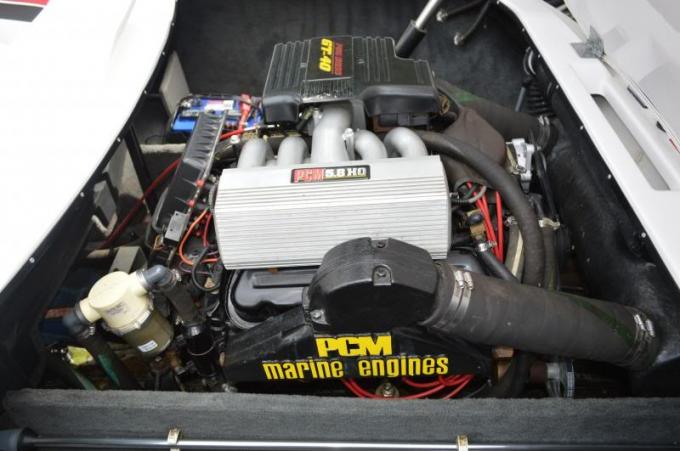

                      My boat is still covered up but in the only picture I have it looks like it says Pro Boss GT 40 on the cover. I know it's the first year multi port FI. The only difference between yours and mine besides maybe computer tune is the tube intake,and no FCC

                            "In 94 PCM fuel injected motor was a throttle body Holley with Pro Tech ignition. This motor was rated at 310hp and when running correctly was the most awesome Ford produced by PCM (in production). The bad news is the Pro Tech ignition parts are running scarce and consumers are paying a premium price to get them. The Holley throttle body on this unit is equal to a 900cfm Holley carb and this motor could perform
                            In 95 PCM introduced the GT 40 as Mid Ohio said same block and heads with a Ford multiport fuel delivery system and Ford electronics. Not the same stuff you find in Ford car, yet Ford product. Injectors are different. Another note is the FCC unit was not introduced until 96 so 95s will not have a fuel control cell."
