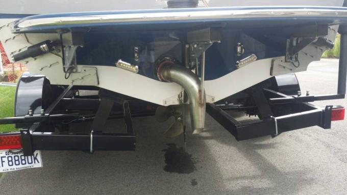

          Here's mine, cost maybe $20 in material and worked great all last Summer
            GREAT job! Thats a nice option for the price. How are the connections made?

                the rubber hose to boat with hose clamp makes perfect sense...but how did you attach the rubber hose to to black pvc? regular pvc cement work or some other glue?
                  it took some trial and error because it fell off the first couple times out. the rubber hose to the stock plastic outlet is hose clamped, and the abs elbows and such have pvc cement holding them together. that wasn't enough alone to hold it under throttle though, so i added stainless screws to the exit side of the rubber hose (nuts and bolts added from the inside). there was still some twisting of the downpipe (outward) after a couple rides so i added two stainless screws to each elbow on the exit side to keep that from happening. the original downpipe came out after a couple weeks, so i replaced it and added two stainless screws where the downpipe mates to the 2:1 exit elbow and haven't had a problem since. in addition to that and not pictured is some galvanized wire that i wrapped around the pipe on each side and then around the fixed wake plate adjusters to make sure it wouldn't come off. no issues since doing that. also not pictured is that once i replaced that downpipe, i cut the exit at an angle outward much like the traditional FAE.
                  hope that helps!
