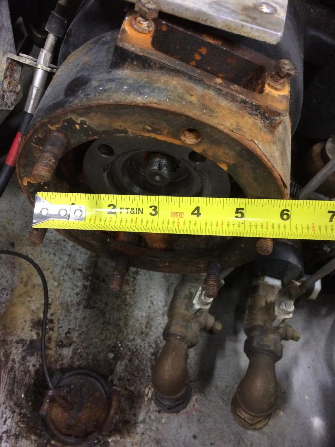

          There's a spline flange on the output shaft on the tranny that bolts to the input flange of the Vdrive. Once you part the two flanges you'll see a 1-1/4" Nut that secures the tranny side flange onto the tranny output which is a spline drive output with a threaded tip. It's a pain to remove, the Nut is punched onto the tranny spline drive and requires grinding the punch out then hitting it with a good size impact wrench. You don't have to remove this Nut or flange in order to split the case on the tranny and replace the forward and reverse clutch sets. Leave the flange and the flange housing attached to the tranny and save yourself the headache.
          Flange only needs to come off if you plan on replacing the tranny output oil seal.
          in this pic you can see the rusty flange housing and the tranny output flange with the 1-1/4" Nut removed. Leave all this
          intact unless your also wanting to replace the tranny front and rear oil seals.
