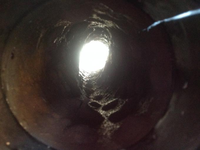

    While you are getting your boat cleaned up for the warmer weather. Inspect your exhaust hoses. I had one that was deformed, not round anymore, It was under the fuel tank so it was hard to see, but after I had removed it, I discovered it was shot the inside was all blistered up. So at some point and time before I purchased the boat it, had run hot. Will try to post pictures. Click image for larger version
