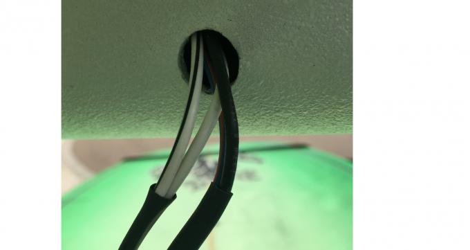

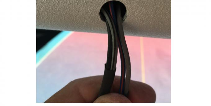

    pulled the rubber caps off my Tower where the INSIDE pair of Speakers would go.
    The Out have Factory installed JL-7.7 with 1 pair wired to each.
    the inside rubber plugs revealed 2- PAIRs of wires on each.
    All 4 Pairs are different color configs
    I'm assuming 1 Pair from each is for the Tower Speaker and is likely to be found tied off down by the Amp Section.
    What would the other Pair be?
    LED Speaker Ring?
    Over Head Light option? ( when I turn this feature on in the Boat nothing happens and I can't find anything in the tower.
    Boat is 2016 G21 with Elite Stereo and Tower Prerig options, 1- JL 8ch amp, 1- JL 4ch amp

    One set could be going to Nav light and the other that is not speaker wire (white and white with black or gray and gray with black is speaker wire) is probably the over head lights. Some factory speakers have a little light in the bottom of them. Speakers wires on my boats have come up the port side and lights either overhead or Nav come up the Starboard.
    Look under where the tower base is and you can trace wires back to amp area or back to dash...
    Last edited by Neverenough; 04-15-2017, 10:03 AM. Reason: Also wiring will have writing on it to tell you what it is in most cases but youll probably have to look where tower base is to see enough of wires

      Overhead lights
