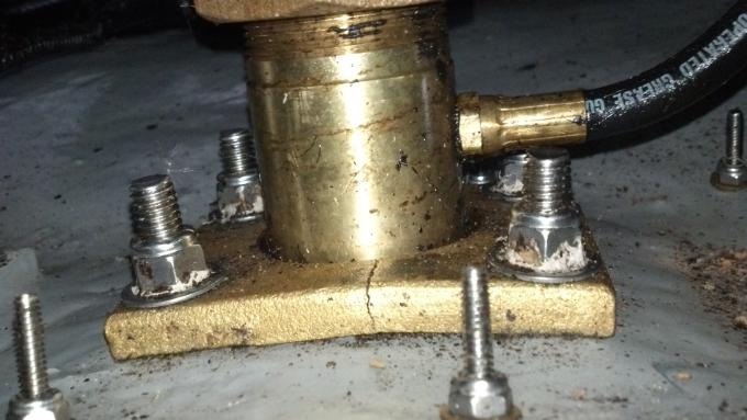

    Anyone got a pic of the zerk fitting on their older SAN rudder port used for greasing the rudder? Pulled mine and looking to drill it out for a zerk but not sure if it should go on the side or the back with a 90 zerk fitting. I forgot where easiest access would be because my boat has been apart for so long. I don't want to drill it and then not be able to access it with the grease gun because other components are in the way.

    Here is a pic of mine, a 2005 SANTE. This has the remote fitting. I think it is on the back side, but I do not have access to my boat today.Click image for larger version

      Yes I can tell that's the back rear facing side. Thanks!
