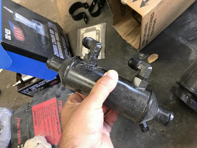

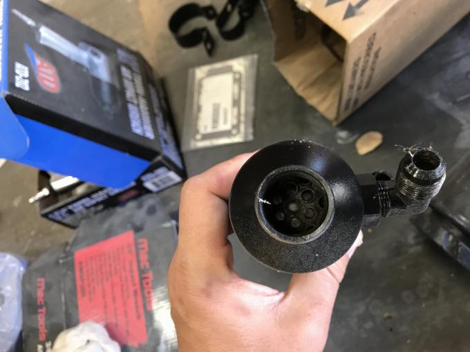

            Check your transmission cooler. It could be plugged. It's the only component between your water strainer and your raw water pump if I recall.
            • t.franscioni
              • Jun 2014
              • 715
              • United States
              • 2002 SANTE
              #21
              Here's a pic of the tranny cooler. This is from a GT40. If you have the Excalibur it might be a little longer than this one. But you can see there's plenty of room for clogging in there. Pretty sure this is inbetween your water filter and water pump could be wrong though... this would be the only point of blockage to your raw water pump from your filter where you said you do have water?

                #22
                I actually thought it might be that too but that is after where I tried the bucket test, so it is from the fake a lake, past the vdrive then water filter then I put the bucket then the transmission cooler, then the water pump. So it would have to be before the water filter. Appreciate all the help

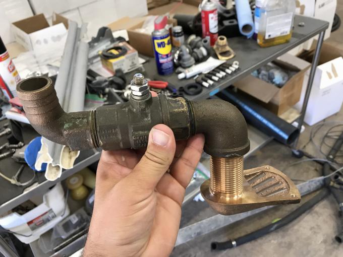

                      hmmm not sure I'm following what your describing is happening with the bucket test but if your saying "it has to be before the water filter" as in the plug is before the water filter then I'd say your ball valve is off because that's the only component inbetween your way pickup on bottom of hull and your water filter.

                          #27
                          Water pickup and ball valve (without the On/off handle installed)

                                #30
                                Originally posted by erikj View Post
                                Sent from my SM-G950U using PLT Nautique mobile app
