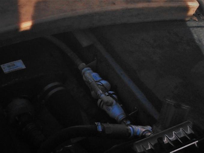

    Ballast is limited to stock hard tanks right now, I believe they are 200 lbs each. Fill time is longer than it should be for what these pumps are rated for, 800gph. Should be about 5 minutes, takes about 15 now.
    I have been looking into additional ballast and have not seen this configuration anywhere. Is this normal? Fill and drain pumps in series. It is set up like a reversible pump. Wondering if that may be causing too much resistance.
    Also, there appear to be check valves on the vent lines at the top of each tank. The way this system works the air needs to flow back into the tanks to let them drain, hence the vent line valves. Wondering if these check valves might be causing resistance as well.

    I have never seen anything piggy backed like that. Havin to suck or pump through another aerator pump would kill your full time like you mention. Somebody at some point added those pumps that way , because Tsunamis are relatively new . I am guessing the tsunamis didn't fit in the older locations because they are a bit bigger , and this was his solution. , but this makes zero sense.
    check valves on av bent line are pointless with hard tanks.
    Personally I would start back over and yank all that crap out and re plumb everything , Whomever re did That system really did more
    harm then good.

      Well the pumps you're taking about didn't exist in 1999. These are really just bait-well pumps and yes, they were plumbed up this way. In-line and one filled, the other drained.
      No it isn't even remotely efficient but you have to remember the 1999 Air Nautique was really a Sport Nautique with tanks, tower and graphics. It wasn't initially designed to be a wakeboarding boat. This is pretty primitive compared to today, but it was state-of-the-art in 1999.
      People who've kept these boats and wakeboard regularly have mostly changed all this out. Added multiple inlets in the hull, separate fill/drain paths, etc.

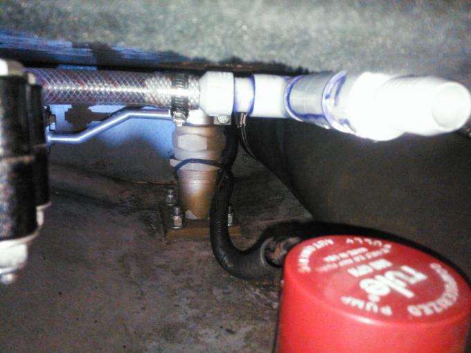

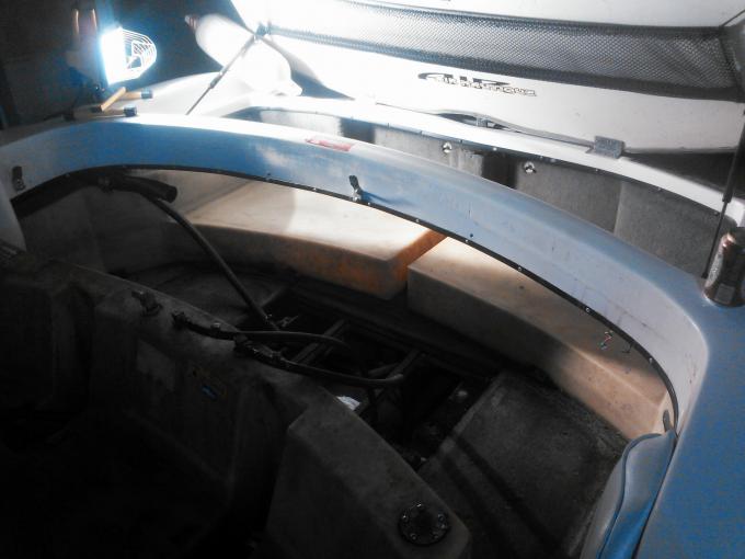

            Yes. Each tank has a knob style valve that opens the vent tubing to allow air in or out. The valves and the toggle switch are under the throttle. The reason I was thinking the pumps were added later is the installation. I will add some pictures. The switch mount is a POS and is secured to the side of the valve assembly with a self tapping screw. It does not match up with the build quality of the rest of the boat.
            I need to get in the boat and look around more. There are 5 thru hulls above water on this boat. The two in the rear corners seem like they should be for draining the ballast tanks, 1 for ballast tank vent, and 2 for the bilge pumps.

              When you fill or empty, do you hear any gurgling sounds from the vents? This indicates air going out/in and same for water. I know that on my boat I can hear the gurgling pretty well when filling the tanks. Maybe everything is slow because of improper airflow in the venting. I'm pretty curious about how your pumps are configured in the picture, looks odd to me. In my boat, both pumps are in line on the same fill line, but not hooked up to one another directly.

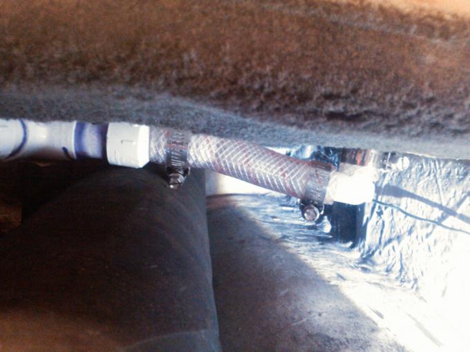

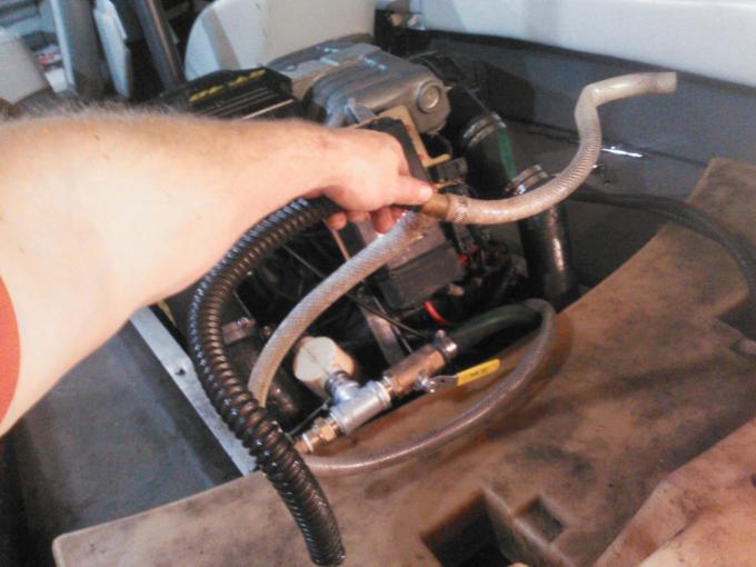

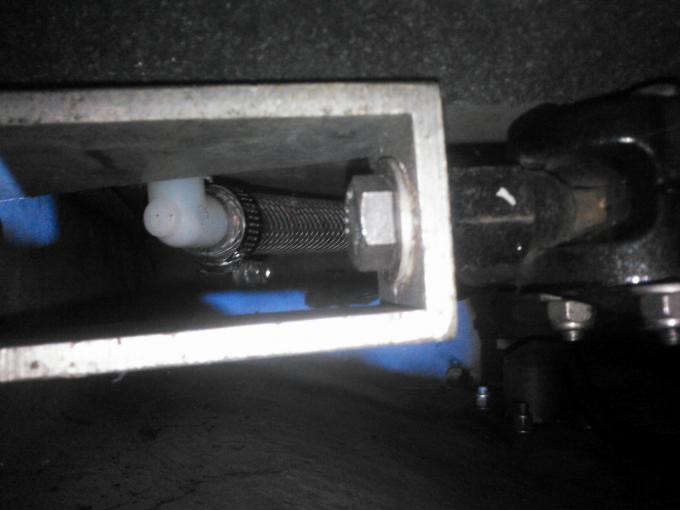

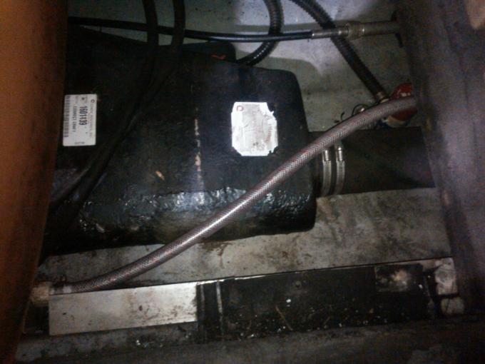

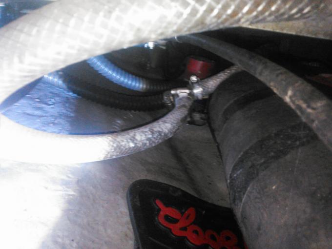

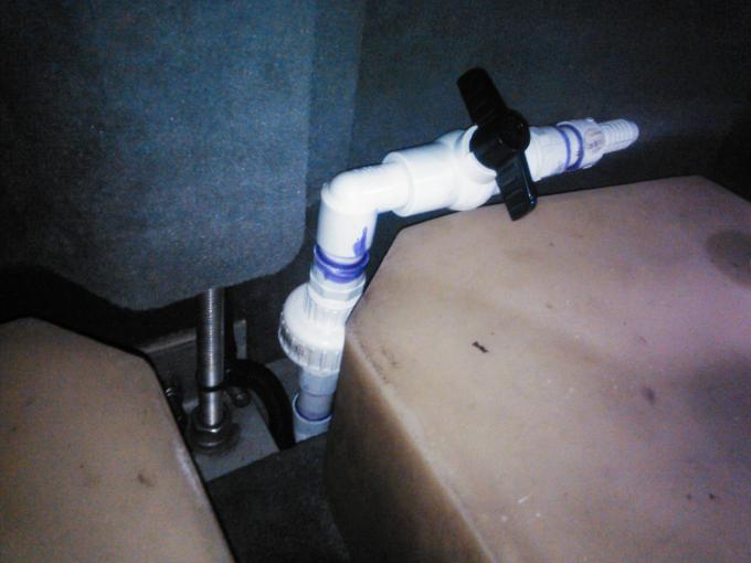

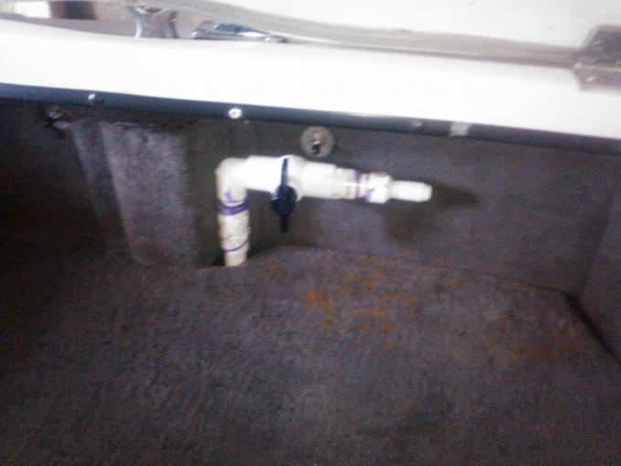

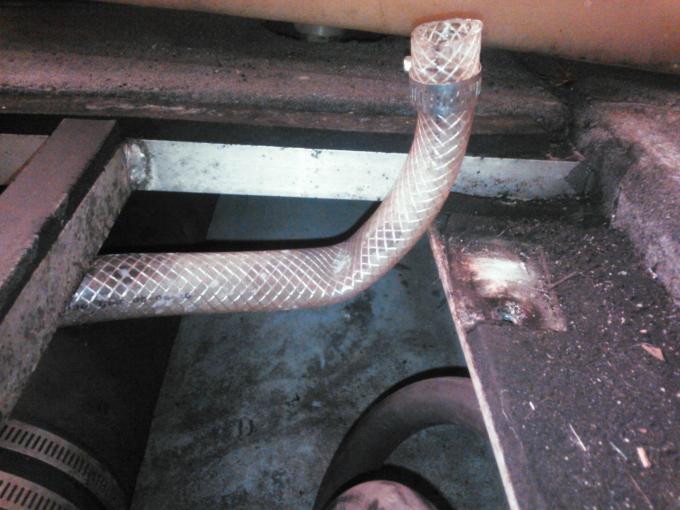

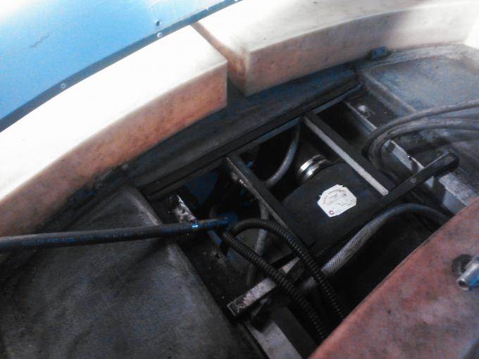

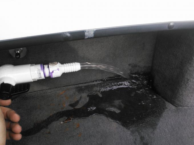

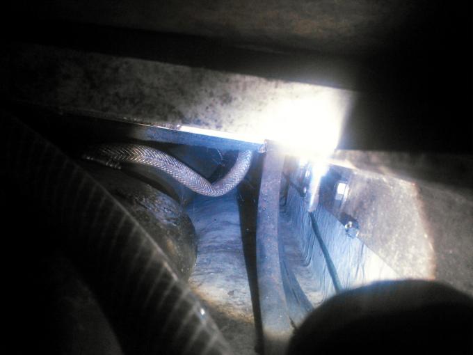

                Spent the evening in the boat. Drain pump is failing, fill pump sounds good. Tubing was poorly run and in bad shape. There was a kink in one of the lines.

                  Some Pictures

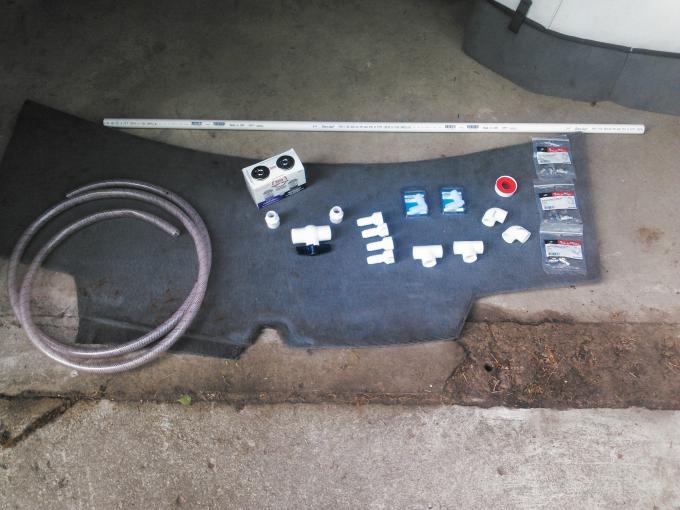

                    Finished up and tested today. All good. Fill time did not change as much as I had hoped. I may end up changing the pump configuration some time.
