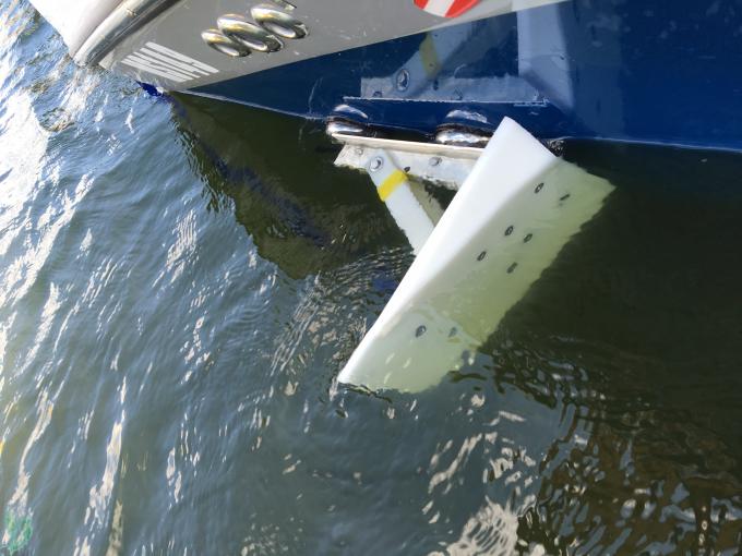

ID:	520983 Great thanks for the tips! Here is my homemade wake gate device, it is a game changer and especially to be able to surf port side for these boats.
