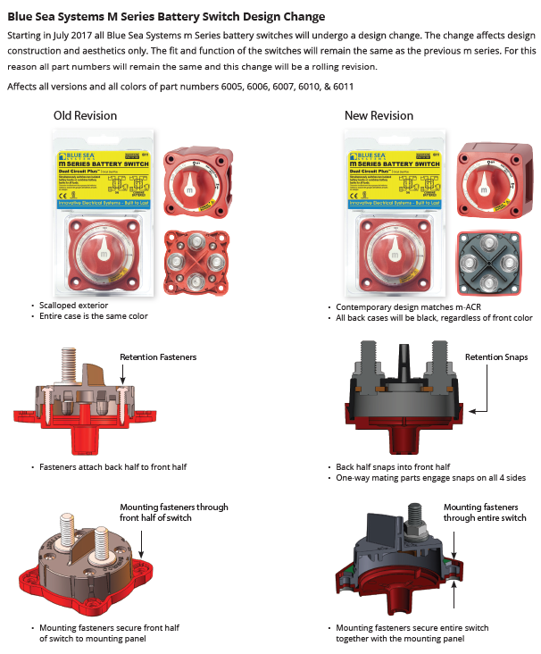

          I just thought i'd add that Blue Sea m-series had failures through-out many boat builders in the industry (boards of many boating sites are littered with photos of the same failure). I understand the backing plate as Nautiques solution to the weakness in the Blue Sea design. Blue Sea has redesigned the m-series switches (see below) here is what Blue Sea sent me in e-mail correspondence I recently had with them:
          Sorry to hear about the trouble. Send me a shipping address and I will get a replacement out for you. Your m-Switch has an "As long as you own it" warranty. The m-Series switches are the smallest plastic battery switches we make, and so require a few specific installation requirements. They were not desiged to support the weight of heavy battery cables. Please see tips below. Torque and Support being the most important to make note of. Make sure to tighten the cable stud fasteners to only 120 Inch pounds of torque.
          Please ask if you have any additional questions.
          m-Series Battery Switch Installation Tips
          1. Proper terminal stud torque: 120 Inch pounds max. Over torqueing will damage internal assemble bosses and lead to future failure.
          2. Wire and cable support: The wires and cables attached to the M-Switch must be supported. The case cannot support multiple large cables and may fail if cables are left hanging from the terminal studs. ABYC recommends support every 18 inches max. We recommend no strain from cables, either hanging or from tight radiuses, be allowed to exert force on the back case of the switch. Figure 1.
          3. Flat mounting surface: Insure mounting surface is flat. Mounting on a curved or irregular surface may distort the case when tightening fasteners.

                    The Switch is made by Blue Sea System, and it has been addressed by Blue Sea. A new more robust housing is whats on the market now. With that said, a contributing factor is the stiff, low strand count cabling correct craft uses, with little strain relief on the cables near the switch.
                    Hundreds of boat builders use Blue Sea switches, yet this only seems to be an issue on CC and maybe one or 2 more brands.

                      MLA, my switch just went out this summer and like I said was replace under warranty. Do you think the replacement switch in my boat is the new and improved Blue Sea switch or just the same model as the one which went out on me? Just trying to figure out when Blue Sea made the upgrade.
