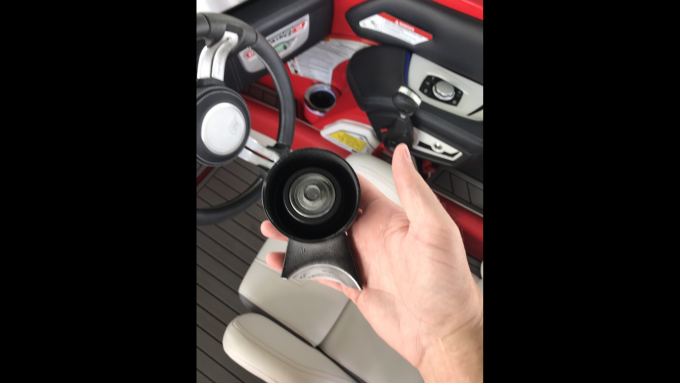

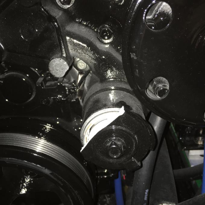

I have a G23 with a H6 (6.2L), the tensioner arm is gone, you can see in the photos where it sheered off completely and left a mark on my harmonic balancer. I have yet to find the pulley for it yet.. I have a great connection at Nautique that got me connected with a PCM rep today to get a new one sent to me. Since my selling dealer is 4 hours from me and they are closed on Monday's. Supposedly PCM has not had this come up yet. Just sharing! I have roughly 40 hours on my PCM H6..

So, does this boat belong to Bmcgeorge or LikensItALot ? Two different users posting the same pictures of the same boat???I own and operate Silver Cove Marine, which is an inboard boat restoration, service, and sales facility located in Mooresville, North Carolina. We specializes in Nautiques and Correct Crafts, and also provide general service for Nautiques fifteen years old and older.
