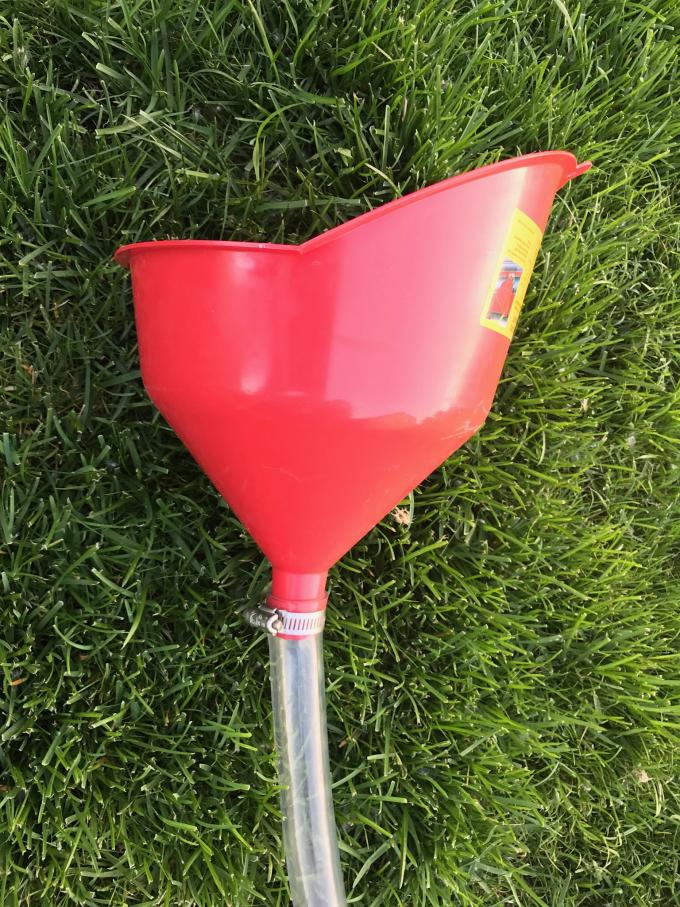

                              My solution:
                              - Get a very large funnel at your local auto parts store (https://shop.advanceautoparts.com/p/...rchTerm=funnel)
                              - Get an 8-10 inch length of clear tubing from your local Home Depot. (1" ID, 1.25" OD) It needs to fit around the outside of the funnel.
                              - Use a hose clamp to secure the hose to the funnel
                              The hose is a mildly snug fit when you push it down into the filler neck on the boat and holds the funnel solidly in place.
                              With this setup you can pour gas in VERY fast, don't use the spout on your gas can, just open the gas can and pour directly.
                              I have four VP Racing gas cans and put 6 gallons in them, I can empty all four cans in under 5 minutes.
                              A couple FYI's:
                              - I love the VP gas cans, very large mouth that pours fast and no need to open the vent cap but they're tall and don't fit in most car trunks. Also tend to tip over much easier than typical gas cans, you'll want to secure them in your vehicle.
                              - If you have the newer style gas can without a separate vent cap (thank you California), then you can easily add them yourself. This will make it pour much better. I also recommend drilling the vent cap itself out to give it even better flow, it makes a big difference. https://picclick.com/60-Yellow-VENT-...660506006.html
                              Click image for larger version  Name:	IMG_2050.JPG Views:	1 Size:	157.9 KB ID:	524995Click image for larger version  Name:	IMG_2051.JPG Views:	1 Size:	80.1 KB ID:	524996
