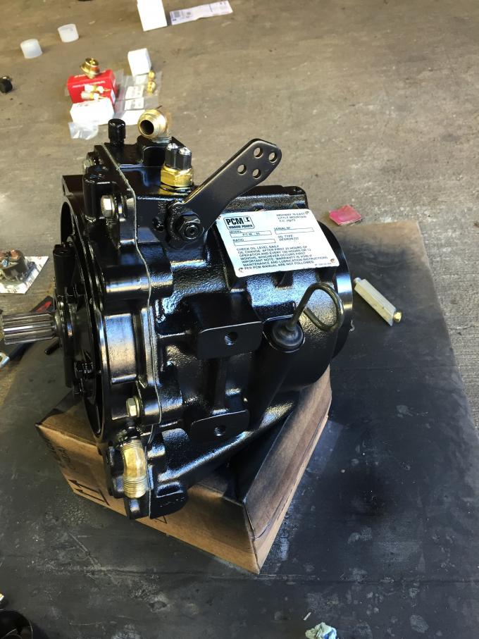

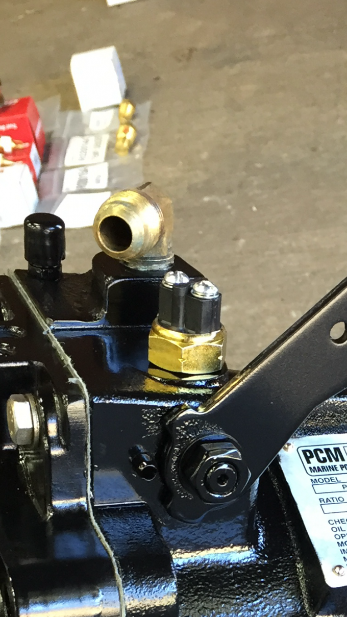

      On top of your transmission. Should have 2 terminals on the switch which threads into the tranny.

          If I recall correctly....To test the linkage you could remove the switch, place the throttle control lever in neutral and look down the hole where the neutral switch would go. You should clearly see the detent through the hole, if not then adjust your tranny shift cable accordingly. When you pull the safety switch you will see a steel ball that when depressed activates the safety feature telling the ignition circuit the boat is in gear and not to let it crank over. In neutral the detent in the transmission should prevent the ball from compressing up into the switch and allow the ignition circuit to crank the engine. Unless you've messed with your transmission linkage prior to this neutral problem then I'd be willing to be its your safety switch that needs cleaning or replacement.
