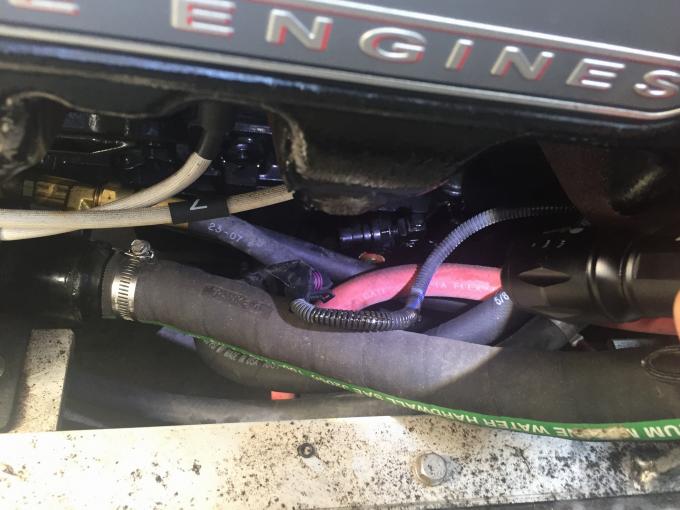

                      Question - I have the new Oil Sensor, but I am struggling to find it. I created a new thread on this, but no one has responded. Can any of you help? I found the exploded diagram in the manuals, but the sending unit and sensor are just hanging out in thin air on the diagram.
                      • homer12
                        • Feb 2016
                        • 584
                        • Indianapolis, IN
                        • 2004 SV211 TE
                        Not sure what you're engine is like, but on my Excalibur 330 it is right down where the remote oil filter lines run to the block. That would put it at front starboard corner on mine. Here is a pic of what mine looks like. Connected to the 'T' - the brass nut looking sensor is the open/closed pressure switch that goes to the engine computer, the black acorn looking sender is what is connected to the gauges.

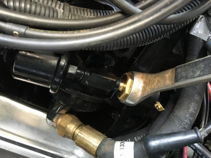

                          Homer12 - Thanks for the picture and info. That helped. My old sensor was all black and the new one is brass. Either the old one was painted or add crap on it because once I pulled it off, the black was flaking off. Anyways...I was not looking for a black sensor.
                          Here is a picture of mine. It's located on the starboard side midway to the front of the engine compartment tucked fairly close to the engine block. I disconnected the cable before I took this picture. It's the one laying in the on the water line.
                          Note: This requires a 1" wrench to remove. I did not have a 1" open wrench so I tried a crescent...that was a fail because the space is too tight. I borrowed a friends wrench.
