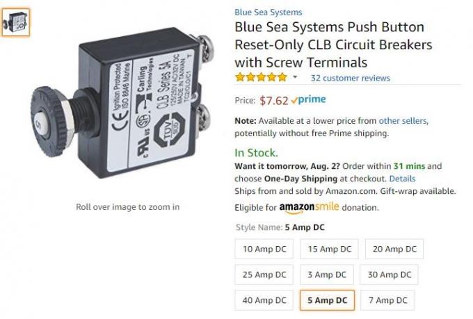

So I purchased this breaker from amazon and added it by the battery cut off switch. You just access via the kick panel. Then I simply disconnected the forward pump (by cutting the wire) from the keypad (Solid brown wire is forward pump, brown with black stripe is aft pump) also accessed via the kick panel) and added a short wire to go from the disconnected pump wire to the new breaker. End result: Aft pump is controlled by Linc so I will still get fault if one is thrown by aft pump. And forward pump is on the new breaker, which I can look to see if breaker is popped by looking at it by the battery switch. Both pumps function the same in that when battery switch is on either position 1 or 2, they both are on. Just on independent circuits.
P.S. I have been out a couple times since the install and no fault...No guarantees, but so far so good.
