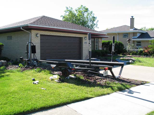

    I have the trailer pictured below that came with my 1989 Ski Nautique. I just removed the hub drums (surge brakes) to replace the bearings, and there are no numbers anywhere on the bearings or seals. Can someone tell me the bearing numbers?

                      Here is the nightmare that has been my week of trying to do bearings.
                      First trip to trailer store: Only got one set of innner/outer bearings. Asked for 2 sets but didn't check the bag.
                      Second trip: Pick up the other set battling rush hour traffic and trains.
                      Home: Realize outer bearings are wrong size. Cups and cones too big (outer AND inner diameter)
                      Sorry for the vent, why does everything have to be a PITA all the time?
                      Atleast we have a cool neighbor that lets us park in his yard.
