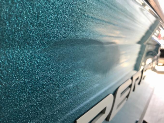

                What Beg4wake said. I just finished taking some good size scratches out. Here is the steps I did.
                Clean, Clean Clean...
                800, 1000, 1500, 2000 and 3000 by hand. You can use a block but you need to be very careful on gelcoat (in my case it was over Reef Blue Flake)
                Once you can see the scratches are gone you will notice a dull haze. I clean again at this point.
                Then with a DA polisher (I use a flex 3401) on a low setting, put 5 dabs of compound on a medium cutting pad. Work the compound on a low setting over the area you need to compound and polish. I have a few that I like. Maguires ultimate compound works great on cars. Worked pretty good on the gelcoat as well but its for heavy compounding. Chemical guys makes a med compound for boats as well that I like. I will compound with a heavy to medium compound then wipe clean. After I will make another pass with a hybrid cutting/polishing compound with the same cutting pad. Finally ill use a polishing pad and a finishing polish. At this point you will have a good as new boat and the only thing left to do is seal and wax. I will seal with jetseal and let dry and finish with collinite fleet wax 885 (apply by hand). The sealant will protect for 6-12 months and the wax for 2-4 so make sure to put the wax over the sealant. Here are my results. First is after sanding. Second is after polish and seal. I forgot to take a photo of the scratch but it was big and deep enough for my thumbnail to catch it. The streaks are just from the light coming in. The scratch is completely gone and undetectable in person. I had 2 large scratches and a few little scratches. The large ones I knew I would have to start with 800 grit but the little ones I started at 1500 grit to see if that would work. Only sand with the min that works. Hope this helps. Lake Austin always has some stuff floating around in it. Usually wood chunks or logs if you go too far up river towards Mansfield Dam but the trade off is the water is glass most of the time and the crowds are much less on the weekends. I had been lucky but finally bumped up against something.
                Click image for larger version  Name:	IMG_0853.JPG Views:	1 Size:	64.9 KB ID:	535461Click image for larger version  Name:	IMG_0859.JPG Views:	1 Size:	54.5 KB ID:	535462

                    Longhorn1186 that scratch repair on the blue flake came out very well. I hope I can emulate it although I don't think any of mine go that deep.
