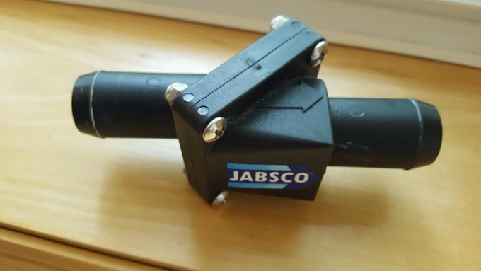

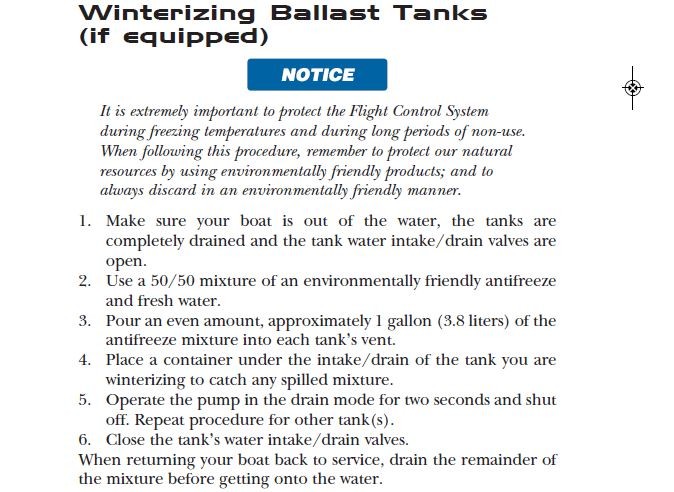

    Maybe someone smarter than me can help me out...
    See picture of valve and instructions. Each ballast bag has an anti-siphon valve. So you can overflow out, but you can't pour in. Whatever you pour in stops at the valve.
    So how exactly are you supposed to winterizing the ballast bags? The only thing I can gather is NOT follow the instructions and do the following:
    1. Take out the impeller
    2. Pour into as directed and hope that what you pour in dilutes the trapped water - from last time you overflowed over the side when filling the bags - dilutes the raw water enough that you don't crack the anti-siphon valve.
    What am I missing here?
    What is the purpose of the anti-siphon valve? There wasn't one on the 2008 sante 210.
    Thoughts?

      Is the valve glued in? Just detach the valve and pour your AF into the tank. Run pumps in reverse

          First post won't work cause you can only easily get to one of the 3 valves.
          2nd post won't work cause when you empty it does not pull the raw water from what is stuck on top of the valve from when you overflowed the last time. I know this cause water was captured on both of the port and starboard sides above the valve. There was a bunch of water there. There is another 1/4 inch line vent line.
          Bottom line is that their instructions are completely garbage cause what ever you pour in is going to sit on top of the closed valve. I verified this....maybe there is enough flex in the valve and the line that it won't cause damage. In case they should just say so.
          Honestly, I would bet they just did not bother correcting the winterizing instructions after they added the anti-siphon valves. So even if no damage get's caused from leaving water above the valves the instructions are wrong cause you just trap antifreeze.
          p.s. i guess if the guy from canada is not having a problem there it must not cause damage to freeze with raw water stuck above the valve...although i guess unless i am wrong 3 screws x 3 pumps is 9, not six...so not sure i can trust a person that can't add 3 + 3 + 3...just kidding.
