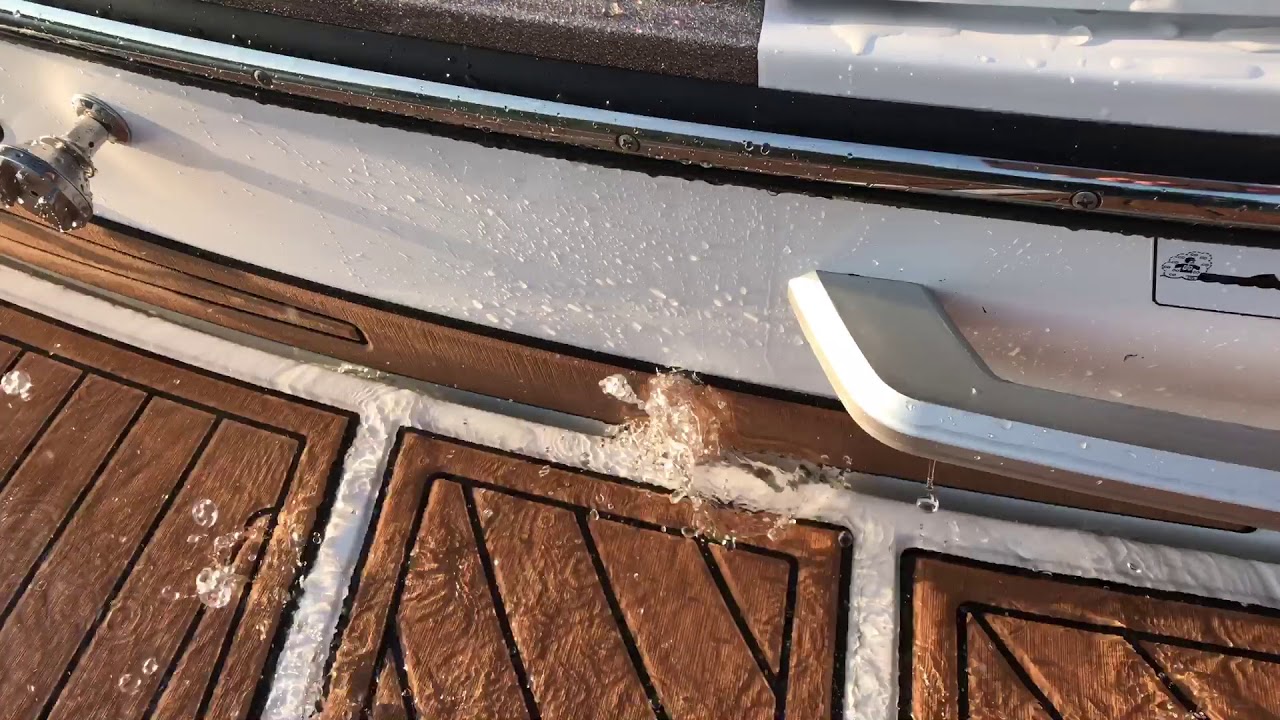

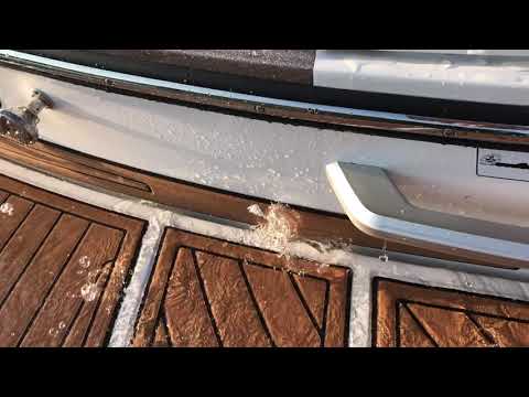

    1) Boat exhaust makes a ton of noise and spits up water from the swim deck at idle. Almost like it doesn't have a surf pipe. Our 2017 did not do this. I hope this is a defect and not a characteristic related to the new stern thrusters.
    Nautique response: This is caused by a new exhaust bypass port which is necessary to prevent the thruster from sucking in the exhaust and becoming ineffective. It isn’t a defect. Engineering has plans to improve this part of the system and these improvements might be, but not necessarily be available as an retrofittable purchase if they are implemented on next model year product.

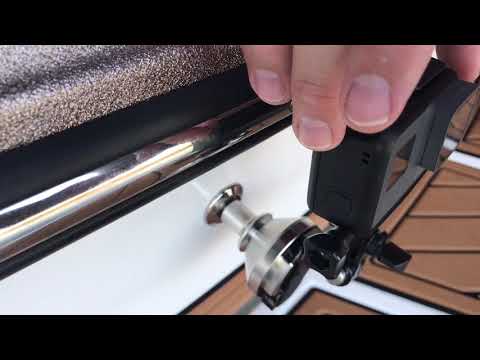

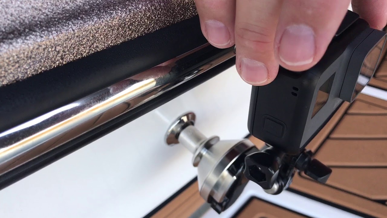

    2) GoPro wiggles in rear mount.
    Nautique response: That excessive wiggling motion is not normal. I understand that it is probably the receiver end which has a defect. I’ll know for sure tomorrow. Submit a warranty claim for the receiver and pin (180179 & 180180 respectively) to get things moving, then we’ll amend or correct your claim based on which part is actually needed.

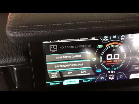

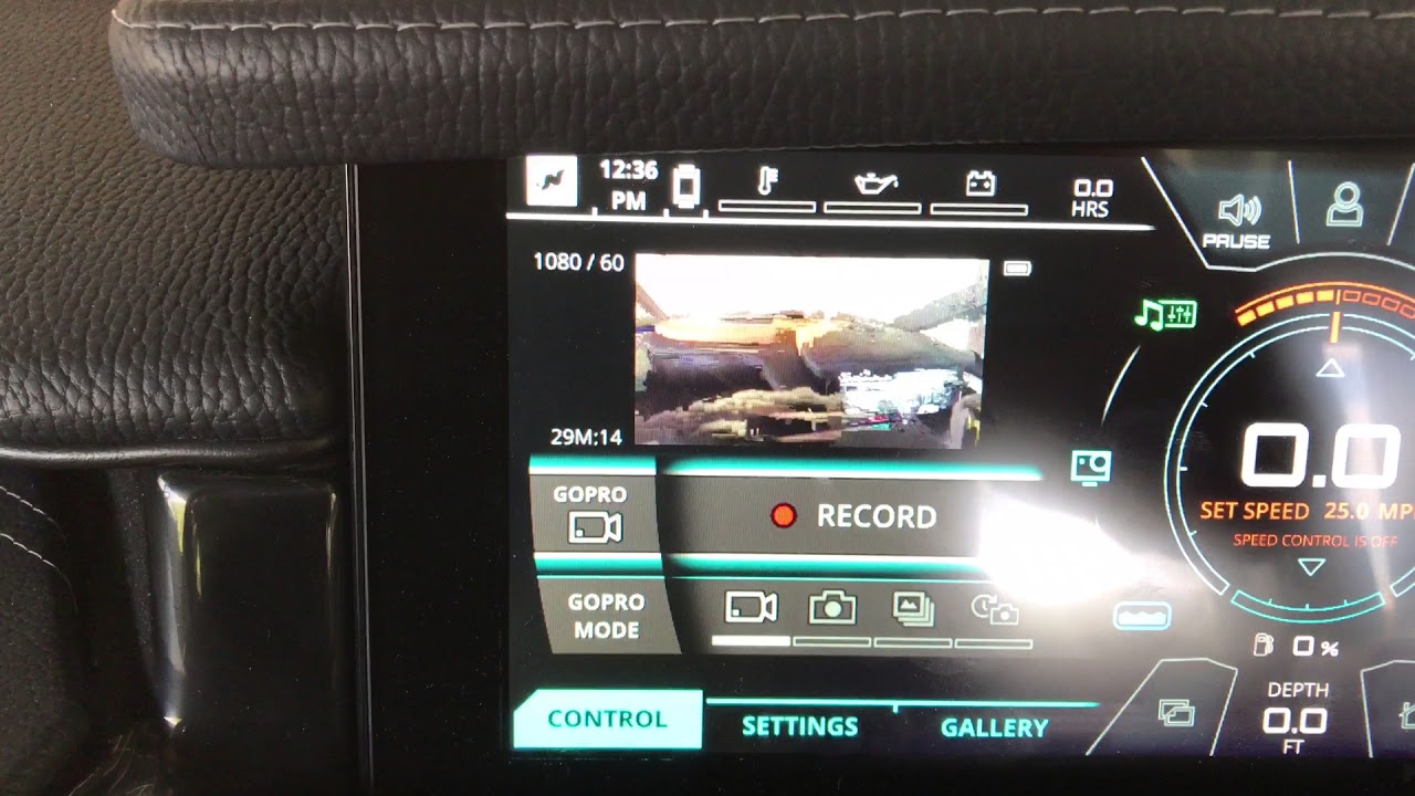

    3) Can't get GoPro to pair consistently. Here is where I am trying to pair the GoPro from the Saved area and it would not pair. This happened throughout the weekend:
    Nautique response: If ever you cannot get the GoPro to pair or connect, we recommend making sure the GoPro is deleted from the “Saved GoPro Cameras” list, then reboot LINC and trying again. The pairing process can be finicky and unfortunately this is due to the beta nature of the tools GoPro has made available for us to use.

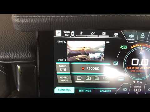

    4) When I did get it to pair, I could not figure out how to turn off the GoPro camera's power and stay off. LINC would actually turn it back on when I manually turned off the GoPro unit. What is the correct way to power down the GoPro?
    Nautique response: As of right now, you cannot turn the GoPro off while you are connected to the LINC display. This is due to limitations of the tools GoPro has made available for us to use to connect and control a GoPro

                      Question on the exhasut/swim deck water issue. How is the severity of the issue affected depending on the ballast level? In the video it looks like your ballast is full based on the water level.
                      • heel5man
                        • Aug 2016
                        • 150
                        • Lake Keowee SC
                        • 2018 G23
                        I believe it’s the same, full ballast or empty. I’ll try to remember to pay attention on our next run and circle back though.
