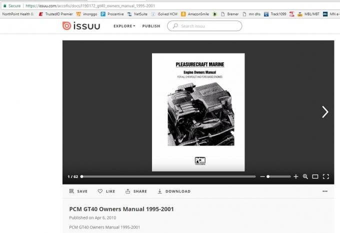

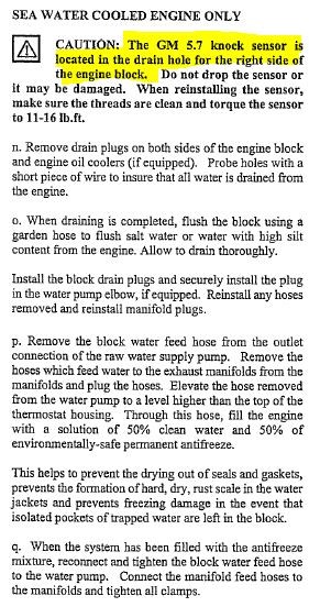

          Per the attached the gt-40 has drain points via the engine block, with one side having to remove the knock sensor.
          IMO: Just drain, and don't put in antifreeze, and keep oil changes on the regular schedule, (do not change at end of season un-necessarily).
          Click image for larger version  Name:	Capture2.JPG Views:	2 Size:	83.4 KB ID:	539872
          Click image for larger version  Name:	Capture.JPG Views:	1 Size:	31.3 KB ID:	539870
                Why does this say GM 5.7 when the GT-40 is a Ford 5.8?

                  #23
                  https://en.wikipedia.org/wiki/Red_herring
                  So you dispute there is a drain plug on either side of the engine? And you disagree that this is the correct manual, but you are NOT offering the correct one yourself?

                      #25
                      Anyone can fire off a question honest or not. No offense, but do some research to show if the manual is correct or not. That would helpful to all. It is supposedly for ford and chevy from 1995 to 2001 as noted above.
                      I did a chunk of research to find what I did. Now you can do some.

                            I love all the name calling, but lets be clear. The GT40 has drain plugs on both sides of the block. Sucking up antifreeze is a method that some people choose to use, but it was never the only way to do it in the 80,90s. When I pull the plugs, I can see with my own eyes that the water is gone. When using the suck method, there is no way of knowing if the liquid coming out of the exhaust is 100% antifreeze or some mixture of antifreeze and water. -50 antifreeze mixed with water is not -50 antifreeze anymore. If you do it the suck method, better make sure you let a few extra gallons come out of the exhaust and don't just kill the engine when liquid comes out. You also need to drain the antifreeze out of the water strainer when you're done.
