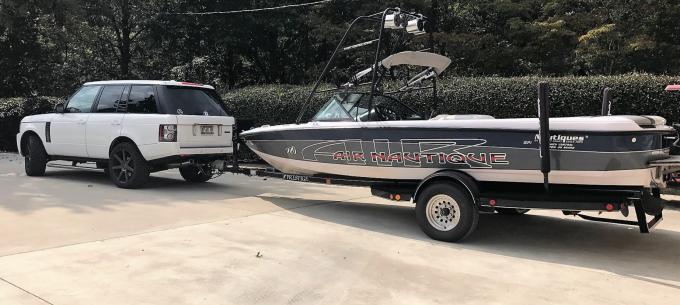

    Newbie here!
    I just picked up a 99 Pro Air a couple weeks ago and been to the lake multiple times already! Love this boat!!! The previous owner took great care of it and it was originally built for a Pro Wakeboarder. Just redid all of the stereo last week. Put in a Kenwood receiver, Polk Audio MM6501 components, JL 10" sub, Kenwood 5 channel amp for the inside, Rockford Fosgate amp and Kicker 6.5s for the tower.
