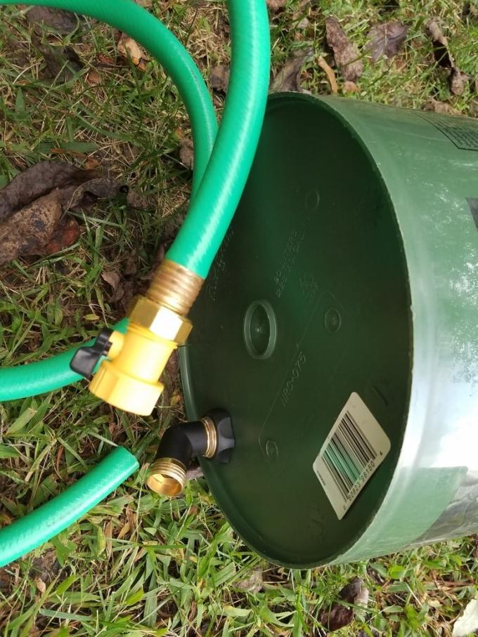

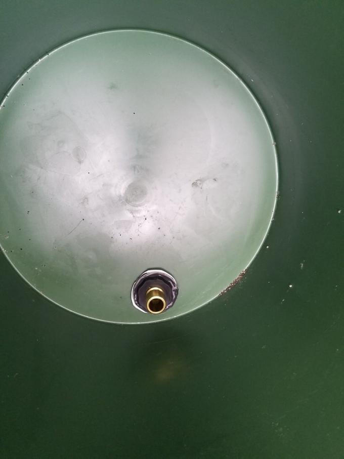

      Do you have a strainer or place to hook up hose to run in driveway? If so...that is where you can input the RV anti-freeze. You can either buy something, or make something pretty easy that allows you to suck in the AF (need a tight seal as engine will suck air easier than fluid). Pics are the 5 gallon bucket I made for that process, got everything at Wal-Mart for less than $20...plus piece of hose. If you don't go that route, you can also pour in where thermostat goes, but not sure that will fill up all cavities without running the engine...and it gets cold in Vermont where you live so don't take any chances. You can add a strainer/hose hookup pretty easy if you are handy. If you do it soon after your water pickup, it will circulate it thru-out entire engine....but always make sure you drain all water first.

            You're on the right track, absolutely. I worked at a marina for a bunch of years and we had several buckets made up for exactly this. The biggest difference was, the hose output was on the side of the bucket near the bottom, that way you could put the bucket down on a flat surface more easily. Harder to get a seal when installing the hose fitting, but just use a big glob of 5200 or something and it'll never leak. What you're doing is exactly how we winterized inboards (run up to temp, oil change, drain water, replace plugs/hoses, suck in non-tox antifreeze with engine running. Disconnect battery, done.

                    Here is the Canadian version, Rona bucket. Bucket full of RV antifreeze, 5 gallons, house water in on right, hose to boat's engine flush kit on left. Once thermostat opens, running ten minutes, open bucket valve, top, shut off house water, right, draw 5 gallons antifreeze into engine, shut down engine. As insurance, I remove plugs and drain all water/antifreeze. The sink is just for demonstration purposes. All in for $20, bucket from Rona, fittings from Amazom.
