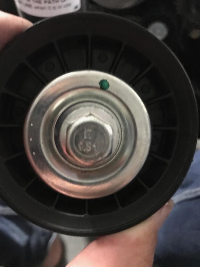

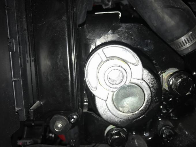

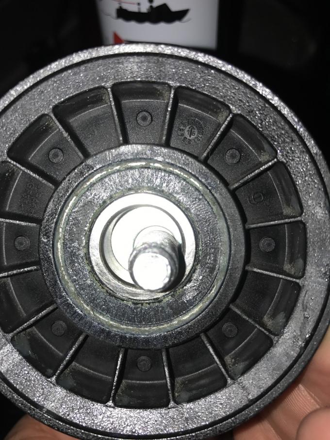

      I have the whole diagram showing the belt routing. There is no tensioner that I can see on the anchor point. It is just a 15mm hex bolt that runs through the pulley. And it pulls right off. No rotation. Attached are front and back pictures of the pulley and bolt and the location it came from on the engine.

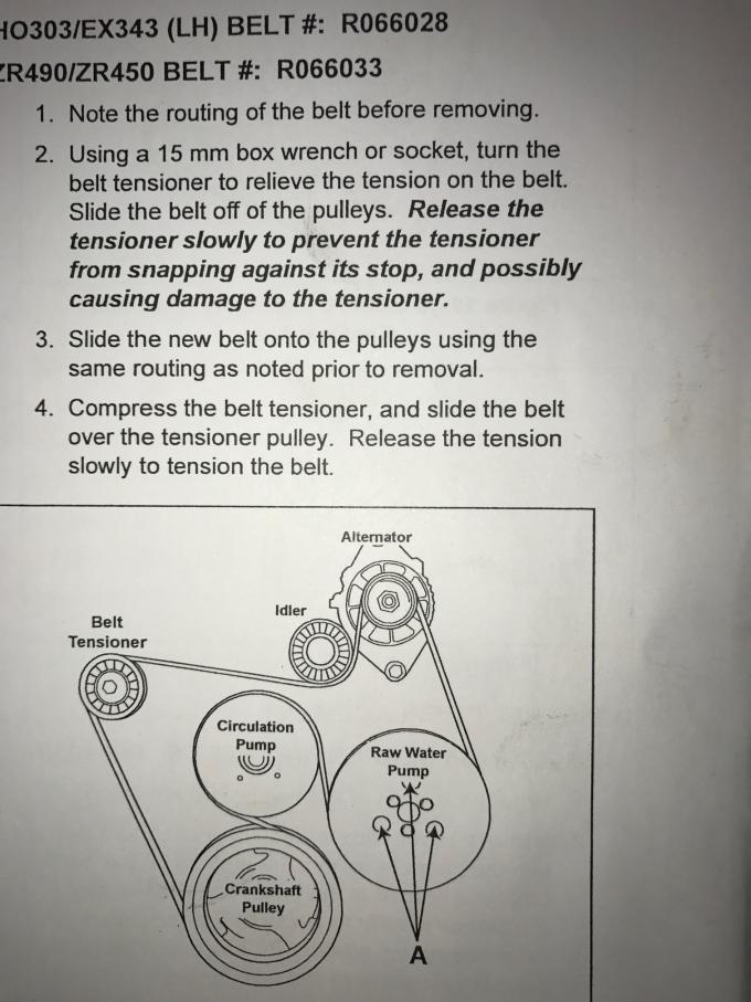

          Upper left pulley facing the engine. PCM manual says that this is the belt tensioner. However I do not see the traditional tensioner that I am familiar with. I attached a picture from the manual.

            Picture from the manual.

              As far as operating the tensioner, it's pretty easy. Put a socket wrench on the tensioner bolt and turn it clockwise. That will swing the tensioner over and let you reposition the belt. Not that the easiest way to do this is to put the belt on the alternator, raw water pump, crankshaft and belt tensioner. Leave it off the circulation pump. Then swing the tensioner over and slide it onto the circulation pump.

                  Removing the serpentine belt does not require removing any pulleys at all. From the photos, it looks to me like you took the idler pulley off. You didn't need to do that. Put it back on without the belt. Then (using the diagram above), locate the tensioner. The tensioner is spring loaded. When you turn the socket wrench clockwise, you'll feel the spring.pulling back against you.

                    The belt came off when I took out the impeller. That pulley came off the location of the belt tensioner in the diagram. The idler pulley is smooth and doesn't have a lip on it.
