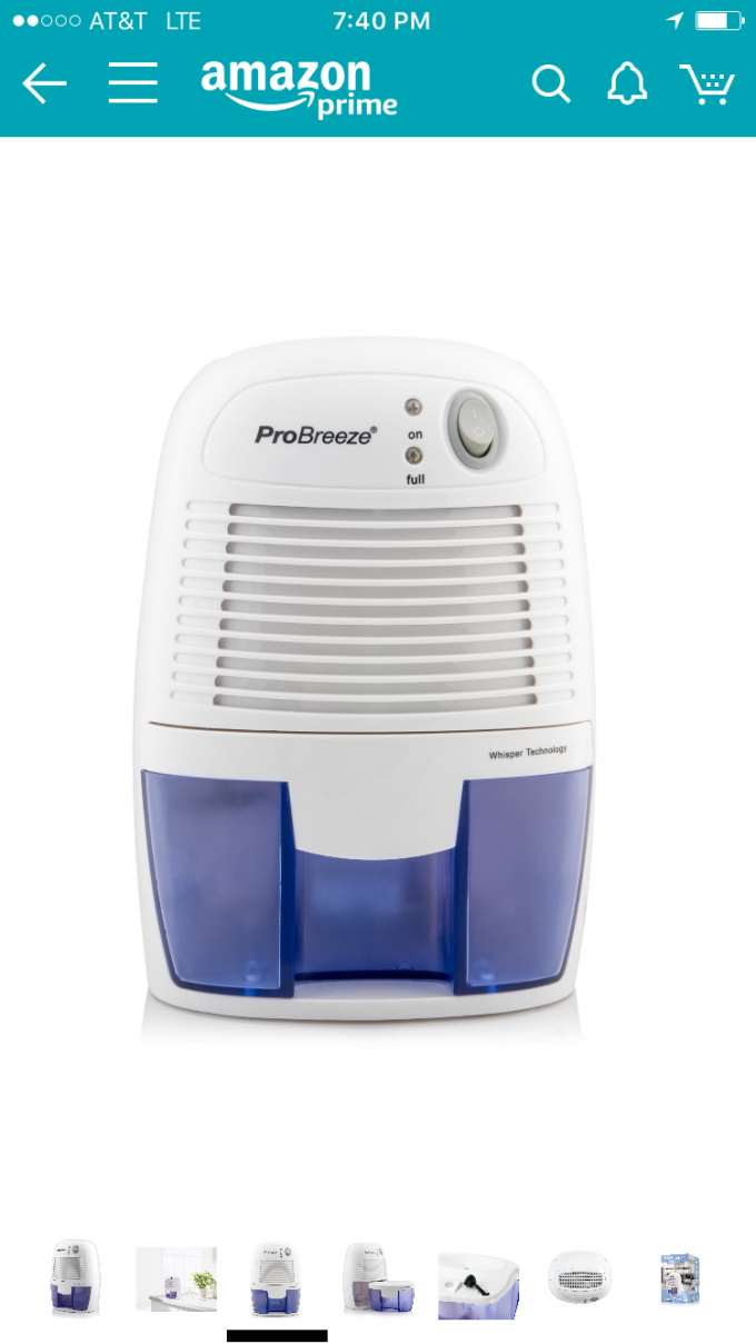

          +1 for everything Charles said. Instead of the damp rid I keep a small dehumidifier under the cover and modified it with some tubing from the reservoir so that it drains down into the bilge that way it does not turn off once the reservoir is full. I run the dehumidifier year round but I am also in Florida.

            Yep. If I was in Florida I'd do the same. Humidity is your enemy. Do you have the make/model of the dehumidifier you're using?

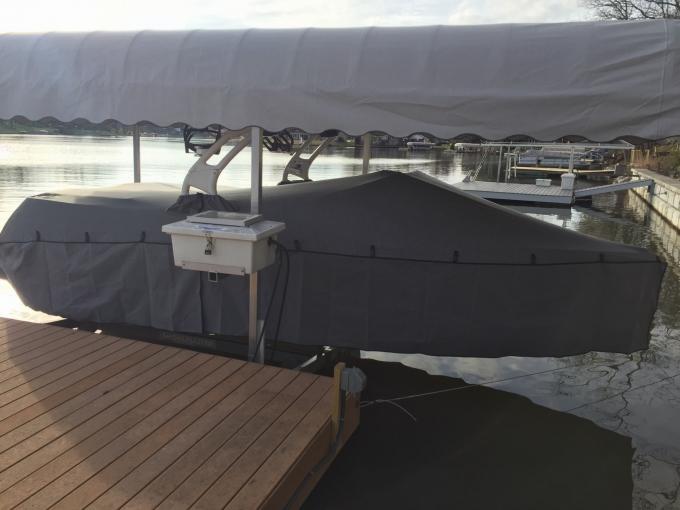

              I agree with everything Charles says here. I keep mine on the lift all summer as well. Mine isn't near as fancy as both of yours since it is just a lift with canopy. I use 303 on all of my seats and dash religiously, paste wax beginning and end of season, spray wax several times throughout the season, wipe the boat down with chami everytime we put it on the lift for longer than a few minutes, and never cover the boat when it is wet (use a fan inside the cover if you must cover it wet). I bought a custom cover from Evolution Covers to keep my boat protected from the sun and elements. It is a sunbrella cover that allows some breathability, but doesn't allow moisture through as long as it has good protectant on it. Evolution cover also set me up with removable side skirts (split in the middle so I can leave them attached when uncovering the boat) as well as a ski deck cover that slips on the back, plus I also had them include a transom cover. The whole boat except for the tower is covered from the elements. I will probably be buying rack and speaker covers from Speakersox for next winter. We do store our boat inside during the winter months though.
              *Another trick I learned is to keep rubbermaid tubs in the V drive lockers to store wet jackets. It is amazing to see how much water collects in those containers from the jackets, gloves, and ropes. All that water would sit on the carpet if those weren't there. We just empty the water out of the containers at the end of the day before we cover the boat.

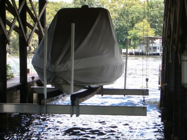

                I am in Florida. My biggest issue is been bug and spider crap so a cover on a lift is an absolute necessity. In addition, skirted covers should be the norm and not the exception.
                I made this cover and it has worked so well that I will never do anything different. I do have a simple bimini that I un-clip and close so newer bimini tops may need some thought. The cover pulls on in 2 minutes and if I am not under the boat house and on the trailer it ponds zero water. I pull the cover over the boat and step off the platform to the dock.

                  I have honestly seen it with 5 different names on it. You can find on Amazon, at Target or Walmart. I think Amazon was about $20 cheaper than anywhere else. Still seems pricey but I really do think it helps. Here is a pic.
