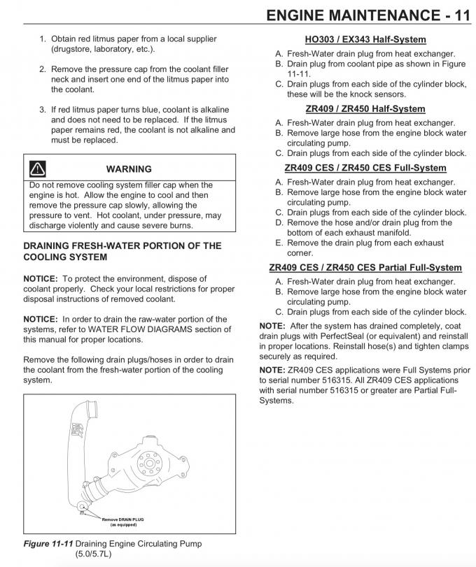

I had some issues on the water last night and ended up throwing some random coolant in the boat (2015 G23 450 Coastal) to limp it home. What are the steps to do a coolant flush so I can drain out what’s in it and replace it with the right stuff?
