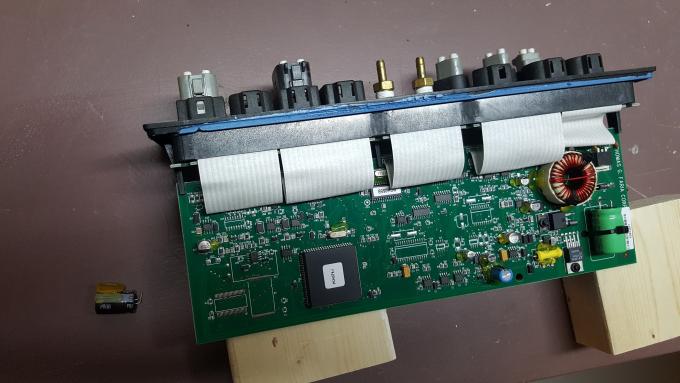

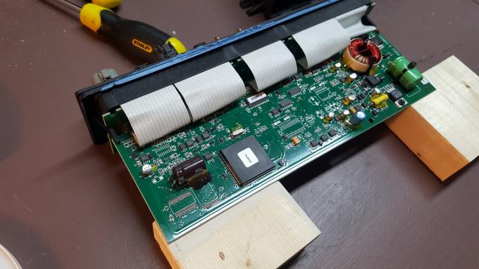

          Took my gateway box off over the weekend, once I had it loose I could hear something rattling around inside.... not a good sign! Once I had it apart I found no evidence of water intrusion as it looked very clean, no corrosion etc, however one of the electronic components had fallen off the board, so that was the source of the rattling. I'm no electronics engineer so I can only guess this is a capacitor.... fortunately it was pretty easy to tell where it belonged and it was pretty easy to solder and glue back in place, so I'm hoping this was what the cause of the malfunctioning depth gauge was. Won't really know until spring until I can water test. I put the box back together and resealed it, so will install it at some point this week. Couple pics attached.
