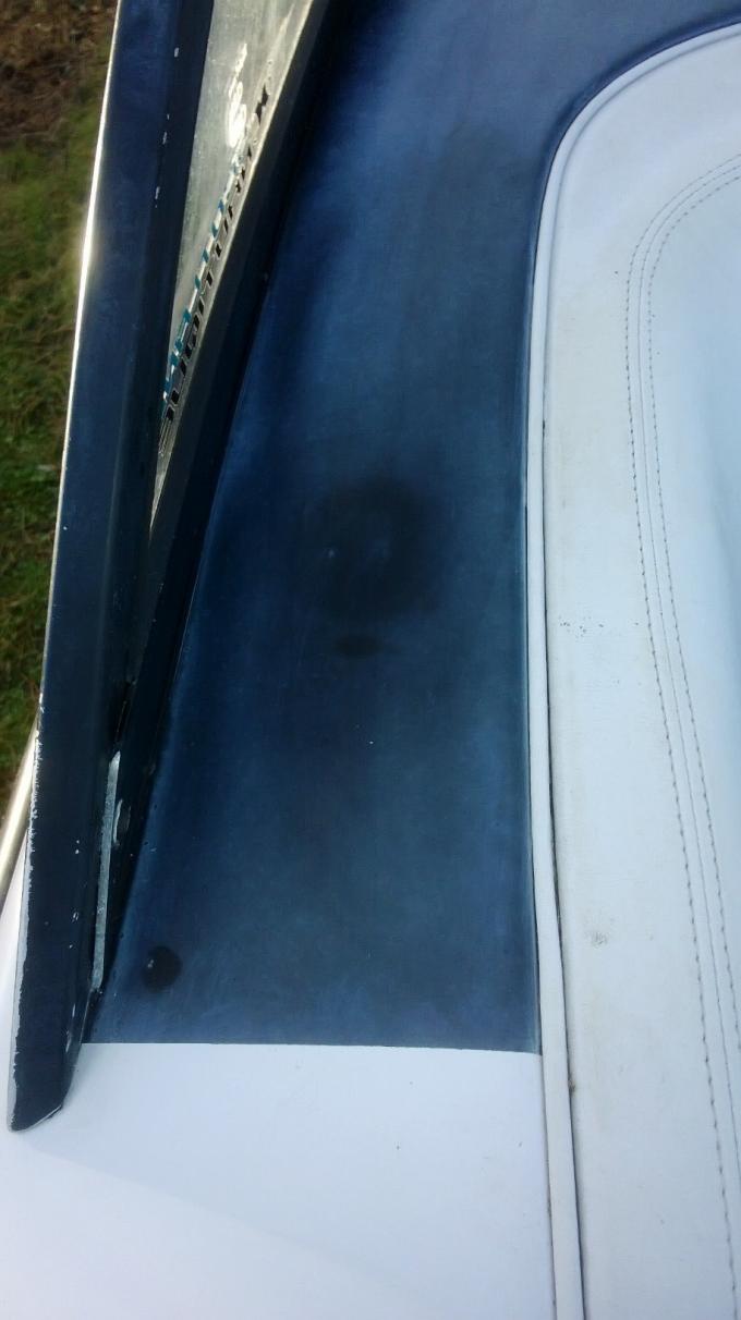

    Hi, i have a problem with the gel coat on top of the area behind the observer seat on my sn 1997 196, it has gone very white looking and it's supposed to be gloss black, I think it has to do with the sun (little as we get over here) .
    Can anybody advise what i can do to retrieve its colour.

    What you're seeing is oxidation. It most certainly can be brought back to a gorgeous finish, but it takes work. Anybody that tells you that you can spray on/wipe off some product that will instantly fix it is full of crap. It doesn't work that way.
    Here's on video: https://www.youtube.com/watch?v=PJ9H8QKu2fw
    Here's another: https://www.youtube.com/watch?v=V8m7ZfUkgUg
    You may have to machine polish. If there are scratches you can feel by dragging a fingernail across them, then you'll need to wet sand them.

      Thanks for the links, i think i am going to need a buffer to do it with, it's good to think that it will come back, realy strange as it's the only part of the boat with the problem but i suppose the black doesn't help I wanted to post a couple of pics but unable to get them on.

          Oh yea, that's totally restorable. I've seen boats that have been sitting out in fields for decades come back looking as good as new.

                3m is great and it's what I use but any compound, polish and wax will work. I think Meguires is more available in the UK.
                A buffer is great if you are going to do the whole boat but that area is kinda small and may be difficult to use a machine without removing the windshield.

                    That's heavy oxidation. At minimum you need a wool pad to really cut that off. Microfiber and foam cutting pads won't be aggresive enough. Best bet is wet sanding, then cut, polish, and finally a nice uv resistant wax. An orbital also will not have the guts on gel coat. You need a DA. Rotary would be the fastest method, but given you are just getting your feet into detailing I would advise staying away. There are a lot of gel coat restoration videos on youtube that more or less walk through the process. Its not automotive clear coat so a little harder to do damage, but still need to have a solid method in restoring that

                      Thanks for that, when I saw it I thought it was going to be a project, I think I may also have to remove the dash pod, but hoping the windscreen can stay.
                      Will post pics before and aft when done but not sure when that will be.
