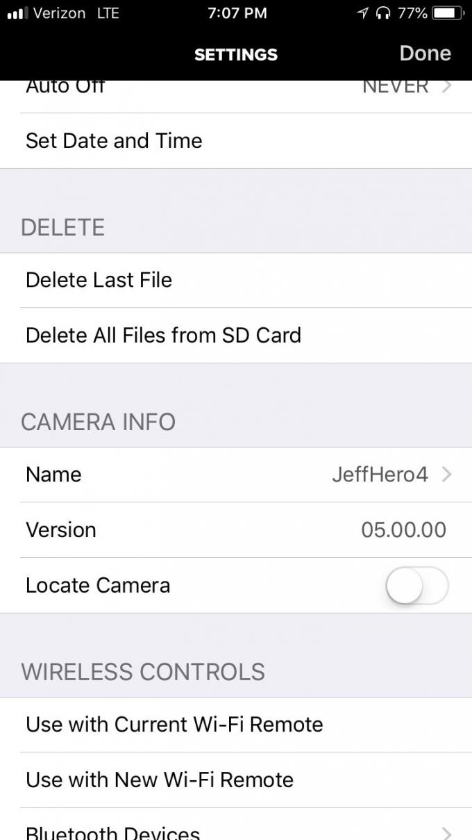

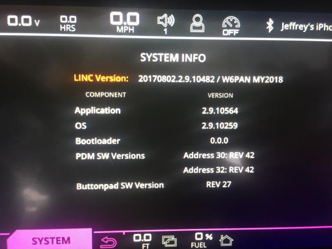

                            OK I took some pictures that show what version link software and what version GoPro software I am using. I only had an issue one day when the preview screen wasn't working every other time it worked just fine.
                            The basic process I follow is to start the boat, turn on the GoPro, turn on the wireless for the GoPro, then select the GoPro on the Link Screen. It usually takes 10-15 seconds then to connect and we are good to go.
                            Let me know if you want to know anything else about my setup.
                            Jeff
