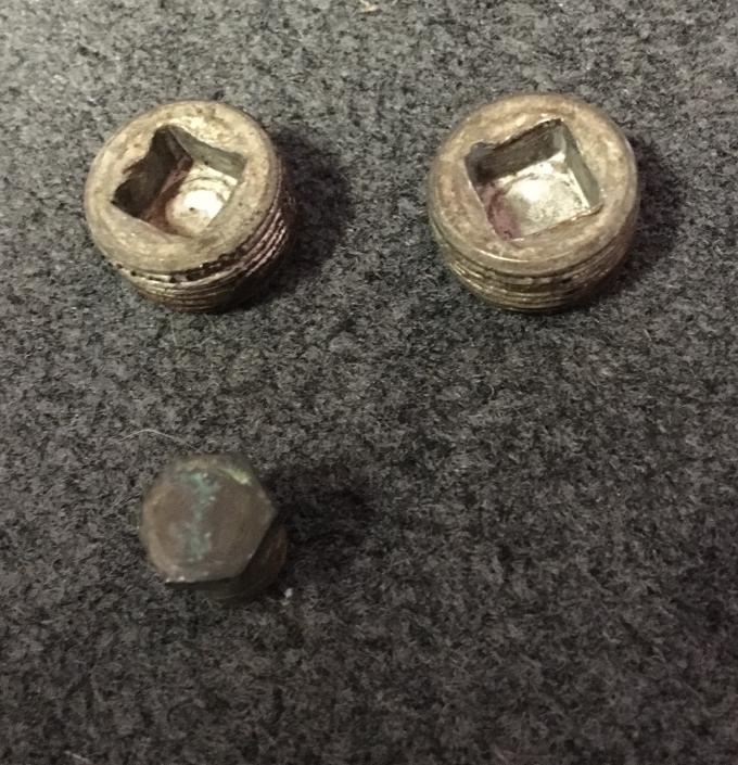

    So I'm getting ready to take my boat out after being winterized and in storage all winter and need help finding the location of the small brass plug?? I know the 3/4s are for the exhaust and I've already got the block plugs in. I just can't figure out where this one goes??
    Boat is a 1996 Ski Nautique with a 5.8pcm gt-40

    Bottom of water pump

      Bottom of "J" tube which leads to water pump.

        Small brass plug can also be engine block drain as well as water pump “j” tube. Look on each side of block below the exhaust headers for any open thread.
