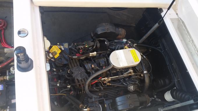

    I would be happy to send a gift card to the person providing the best answer! Any service writers on here? I did a bunch of work on a friends boat and they want to pay me for it. I'm very meticulous when I work on a boat. We're trying to decide what it would have cost if the work was done at a shop or dealership. The friend paid for parts and machine shop service separately. Any intelligent answers, even "Ball-park" answers are welcome. Thanks!
    2003 Super Air 210 (Gray motor cover, not serpentine belt)
    Services I performed:
    1) Diagnose overheating problem to loss of cooling water
    2) Removed destroyed impeller, cleaned debris from hoses, check for issues that caused problem, installed new impeller, replaced raw water strainer gasket
    3) Thermostat housing also leaking, r&r with new gasket
    4) Moved gate valve and repositioned hose clamps that were rubbing on gas tank, replaced missing nut on gate valve with SS
    5) Tried to test engine but muffler is blown up, may have motor damage
    6) Research best price or options for used muffler, other parts
    7) Compression check motor - low compression on adjacent cylinders each bank
    8) R&R panels, seats etc. to get to engine
    9) Remove accessories, all manifolds, distributor, plugs, wiring etc. to r&R heads for valve job
    10) Prep block and manifold surfaces; reinstall all of the above with fresh cylinder heads
    11) Oil and filter change, label filter with engine hours and date
    12) Intermittent no start - diagnosed no power to solenoid wire, found trans cooler hose and battery cables rubbing on neutral safety switch, rerouted hoses and tied cables away, tightened terminal screws on switch
    13) Broken front bilge pump, wires inaccessible without removing fuel tank, made access hole in center compartment, made bracket to better situate pump, installed new pump
    14) Ballast tank pump not working, replaced blown fuse, blew again, found overheated pump is bad, replaced pump with used pump from my stock
    15) Check fluids, add trans fluid
    16) Trailer spare tire bulging, r&r wheel for customer to replace tire, add custom spare cover
    17) Starboard hatch strut fasteners stripped, drilled larger holes, add larger SS screws and machine bolt with nut/washer
    18) Installed new glove box lid strut
    19) No trailer brake lock-out on reverse. Check wiring to recirculation solenoid. Check brake fluid, added fluid to correct problem.
    20) Research size for missing Bearing Buddy; replace one Bearing Buddy and bra
    21) Tighten loose wakeboard rack
    22) Blower and horn not working, replaced blown fuses, repaired broken fuse block, lengthened hot wire, secured other loose wires
    23) Secured loose wires under side console causing bad connections
    24) No sound to drivers speaker, r&r kick panel, reconnect speaker
