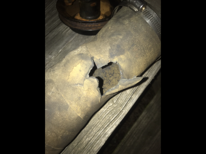

    Just purchased the boat from Miami. Now in fresh water. New to these boats. Alternator was stuck so after replacing replacing the alternator, belt and some fluids (while waiting on impeller to arrive) I decided to take the boat for a stroll. Literally around the block. Just to see if I noticed anything else. Well all seemed okay until one of the 3" exhaust hose bursted. A small amount of water was dripping thru leak causing some steam and there was a tad of blue smoke coming from exhaust out of the back of the boat but went away on my slow return back to marina. I think the blue smoke was just regular buildup burning since everything leads me to believe the boat has been sitting for some time. Does this sound like the impeller completely gave out causing the tubes to overheat and break? Any ideas would be helpful as well as any tips for impeller replacement and flushing the system. Id like for an tech to take a look and I understand boats are money pits but I just really hate paying a dealer to replace something or "tune up" if its something obvious or simple

          If water isn't circulating, those exhaust hoses will overheat. They cannot withstand the heat of straght exhaust.

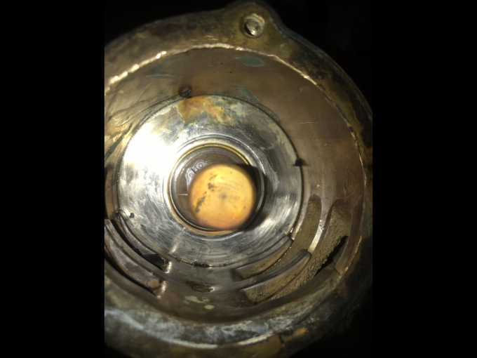

            Water pump is spinning free after removing this impeller . So hopefully this was the cause of the problems im facing at the moment. What’s the procedure to check the thermostat. I have the all of the exhaust system that gets in the way disassembled so now is the time to check things while they are accessible. I will upload a pic of this poor impeller. Destroyed but doesnt look like to much was lost in the cooling system so a good flush should do it. Also just curious it seems there is a tensioner for the impeller. I suppose this tightens the fins so that it pushes a strong pressure thru the cooling system? Thanks for helping this newbie haha

              I know she looks rough but seems like assembly is doing its job. Ima clean her up good. Just going to be a boat where as things fail i will try to replace parts and clean up as well as i can.

                  Wow, I would say you found the issue alright! Make sure you flush everything out of the cooler, since the vanes that broke off will cause blockage and continue to give you issues.
                  Also, clean that housing up really well, you want the cover nice and smooth so it seals right when you install the new impeller and gasket. Inside as well....you may even want to lightly wet sand with a 1500-2000 grit to get any gunk out and make inside really smooth. When you re-install the impeller, you can use marine grease or dish soap (like dawn) to make the install easier and make sure the impeller vanes are facing the same direction as it was before.
