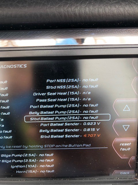

    I just purchased a 2017 SAN 210. This weekend was the first time I have ever had it in the water and after draining the ballasts, I received a circuit fault error message. After playing around with it, I realized that I could reset the faults. However, it happened over and over. I was going to do a full reset but was worried that it might effect other things (my dealer is 3 hours away). I attached a picture (Fault.jpg) and it looks like the STBD ballast is drawing 4.707 V. That seems to be high from what I have read. How would I go about fixing this? Any ideas? Thank you in advance.

      That says ballast sender is 4.7 Volts. There is "no fault" with any of pumps. Looks to me like something is wrong with the Starboard ballast sender. Does the ballast fill/drain properly? Does the starboard ballast gauge function properly?
      If there is something wrong with the starboard ballast sender I would expect the starboard ballast gauge would not function properly.

        Does the boat have hard tanks or sacs? If hard tanks then yeah I agree it sounds like the sender and not the pump.. in which case you could disconnect the sender and see if the problem goes away. so maybe the gauge won't work but you'll know then...

          Thanks for all the suggestions and I have a call into the dealer. Yes, the gauge seem to work and the tanks are both draining and filling fine. It is a combination of hard tanks and and sacs.
