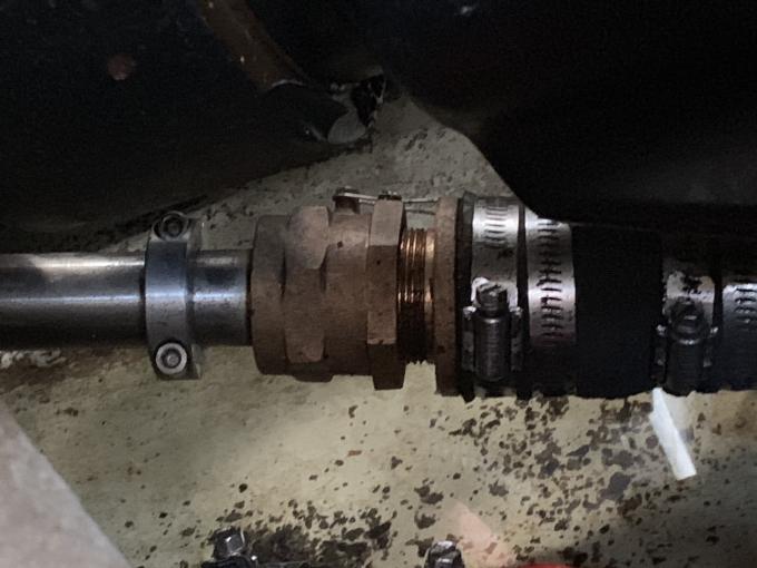

          sorry for the delayed response and Pic, can you share with me how to tighten to reduce water dripping from V-shaft, thanks, Bill Click image for larger version

            Originally posted by bpwsross View Post
            sorry for the delayed response and Pic, can you share with me how to tighten to reduce water dripping from V-shaft, thanks, Bill Click image for larger version  Name:	BbmBDtF3SD2oh+K6QXWsDQ.jpg Views:	0 Size:	42.5 KB ID:	590093
            OK, is it DRIPPING or POURING out around the shaft? If it's dripping then leave it alone. Seriously. It's doing exactly what it's supposed to do. We've seen more than one overheated stuffing box here because someone went to "fix the dripping" and ended up ruining their stuffing box and drive shaft.

              ok so it is dripping, drops continuously from the time the boat is put in the water, remains the same whether in gear, going forward, reverse or neutral - drip, drip, drip, drip...not pouring
                Perfect. It's doing exactly what it's supposed to do. Tight enough not to pour, loose enough to keep the stuffing box and drive shaft cooled properly.
                Having your bilge pumps come on from time to time is actually a good things. You know they work.
