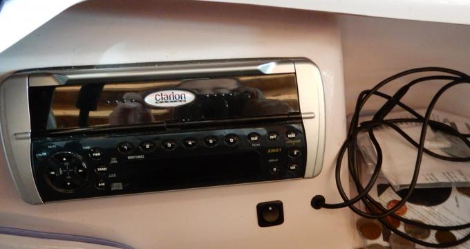

      Here is the unit with the switch located underneath. Typically we just flip that switch and the unit switches to ACC mode. Any advice on why it won't switch to "ACC" now?

        The switch and the ipod connect are a modification. The 03 didn't have a way to connect an mp3 player. I would start my sliding under the radio and make sure everything is still connected.

          I'm wondering if that's what it is. I just put a nose sack up front and had to shove more orange life jackets right under there.
