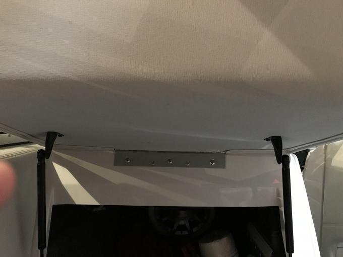

Need a pic of your 230 copilot seat (underneath)
  • crowmobe540
    • Feb 2006
    • 372
    • Incline Village, Nevada
    • 2017 G23 Previous: '18 G23, '16 G25, '07 236; '02 SANTE; '96 SS
    I just got my skin/seat back from nautique for the co-pilot (backfacing with storage underneath - best seat in the house) seat of my 07 236/230. I'm trying to determine where to mount the brackets that hold the gas shocks on the underside of the seat. Was hoping somebody could snap a couple of pictures showing where the brackets are mounted on theirs before I start drilling holes in my new seat skin.
    Thanks in advance.

        Can you post a pic? I should have my 2007 236 out this weekend and I can send you pics.

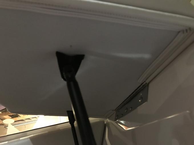

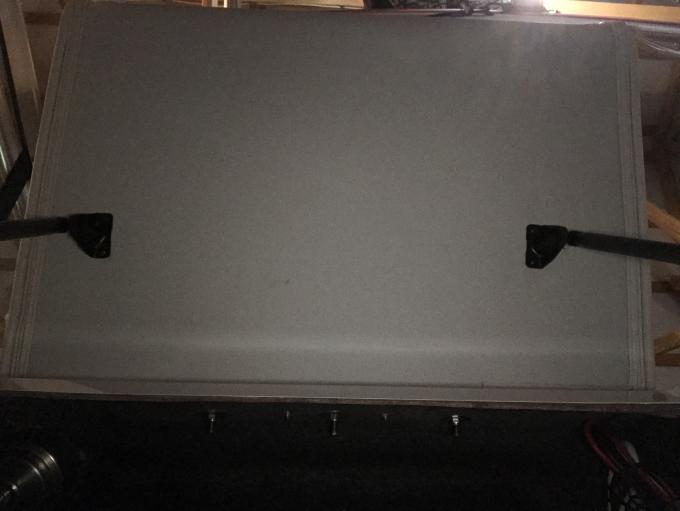

ID:	556226 Click image for larger version
ID:	556227 Click image for larger version
ID:	556228 Here you go, hope this helps. On both the port and starboard brackets they were
          7-1/4" from very end of the seat/vinyl (hinge end) to the center of the bracket. On the Port side from the very edge of the vinyl to the centerline of the screw holes was 3-1/2". On the Starboard side from the very edge of the vinyl to the centerline of screw holes was 5-1/2"

              Thanks so much. This should be what I need! Awesome work
