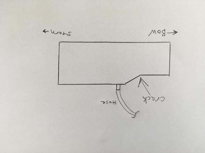

        Okay, this problem drove me crazy until I found where it was coming from. To access the hose fitting, you'll need to remove the starboard seat back which backs up to the helm in the bow. For a better view of the top of the tank (where mine leaked), you'll need to remove the little divider panel between the bow storage and helm (two screws) and stick your head in there. This is where being a contortionist helps. They had to empty and remove the fuel tank when they replaced my ballast tank. I'll post a sketch of where my tank leaked. I was able to make a good temporary fix by patching the crack with some duct seal tape from Target for $12. It's almost impossible to find anything to stick to that tank material.

            Thanks. I was out today and reached back and felt where the hose attached to the hard tank and felt nothing wet so am thinking it must be a leak I the hard tank and the bow bag and leaking back into the hard tank. Sounds like time to bring in the pros....
