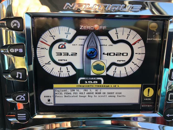

    Looking for some help on a diagnostic code. When doing a hard acceleration while pulling a skier out of the water we occasionally get the code in the picture below. It doesnโ€™t happen every time. Does it have to do with a throttle position sensor? The boat is a 2011 Ski Nautique 200 with a ZR 409.

    That sure sounds like Throttle Position Sensor to me. Obviously the ECM thinks this is a car since it talks about the accelerator pedal. You should contact a mechanic and see if we're on the right track here though.
