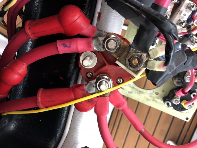

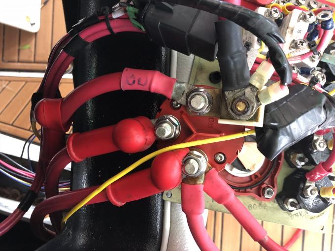

    Just in case your battery selector ever splits apart and does not make contact, here is how you can bypass it. Especially when it happens on a holiday (ask me how I know).
    step 1 - get access to the back of the selector
    step 2 - move one of the other batteries to the common post (see pics)
    step 3 - enjoy the rest of your day having only been slightly delayed
    I realize this is some basic stuff for many of you, but if I help one person save their weekend then it is worth it.
    Pic on left is the before
    pic on right is the after
