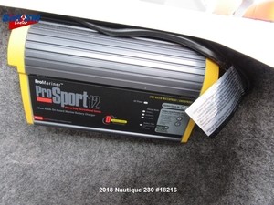

              I found this picture of a charger installed on a 2018 230. Can anyone tell where on the boat it's located?
                hahah sail and ski eh?
                that is under the port rear seats right in front of the motor box. it in mounted into the wall of the front of the port ballast tank. be careful with screw lengths there.
                  Thanks! I'd like to avoid extension cables, so that location won't work for me. I'm leaning towards the bulkhead behind the bow seat backs (port side).
