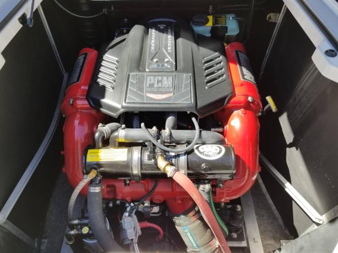

    Identify this 2014 PCM engine...
    Click image for larger version  Name:	00505_jNvHwuh77dL_1200x900.jpg Views:	1 Size:	50.3 KB ID:	563285
    Is this the ZR409 engine? engine is in a 2014 Nautique 230
    thanks.

    It's definitely a 6.0, but I can't tell from the pic what hp. Look at the serial number tag and you'll see either 02-602 or 02-603. If it's 602 it's a 409; 603 is a 450.
      thanks, I'll do that and post back!
        the engine serial is 546039 which you say is a 450 but I got a better picture of the engine and the shroud indicates its a 409...???

          Hmm, interesting. The '14 PCM manual states 603 is a 450 (see page 14)...
          http://pcmengines.com/wp-content/upl...L510010-14.pdf

            I have the ZR409 in my 2014, while very similar...that is not it. My guess....is that its the ZR4 engine.
            See link below....
            http://pcmengines.com/engines/zr4/
