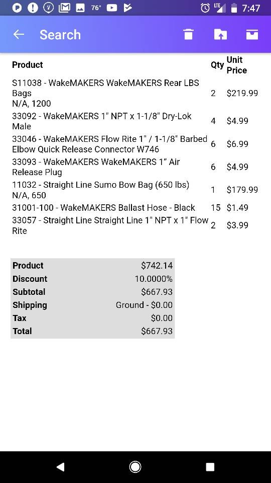

          Actually 1200 in the rear and a 650 in the front

              How did you get the 10% discount? I take it you tied into the vent coming off the belly tank to fill the triangle bag. I am going to contact Wake makers tomorrow and put in a order.
                When you call them, Just ask and they'll honor the 10% off planet Nautique discount.
