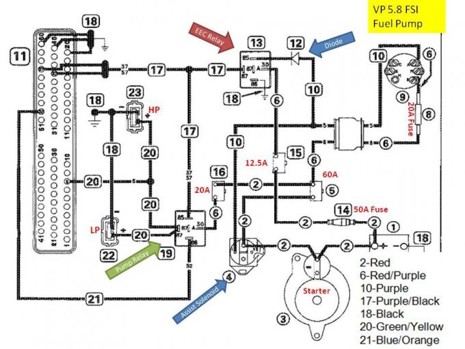

      When you turn the key does your fuel pumps cycle for a few seconds ? If not check the relays powering the fuel pump. When you turn the key relay 1 is energized and sends power (12v) to relay 2 and the ECM. The EMC then applies ground to the relay 2 actuation coil. Relay 2 turns on and powers the pump. I have had both fail on my Nautique.
      Both relays are part number R130011

          Pull a plug and with someone cranking the engine hold threaded part to a ground and see if there is a spark.
          Also, is the plug dry ?
          If the fuel pumps (low pressure and high pressure) are running and there is spark then you may have a problem with the injector signals possible from a harness connection coming undone.
          You can trying pouring a SMALL amount of gas into the plug opening, replace the plug then see if you get an engine fire. If so then it points to a fuel supply problem.
          The high pressure pump is in the fuel control cell and should emit a buzzing sound for a few seconds when the key is turned.
