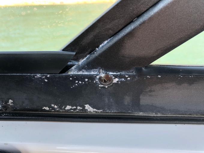

        Is it really rust? The windshield frame is aluminum and may have minor corrosion, but shouldn’t rust. Do you have any pics?

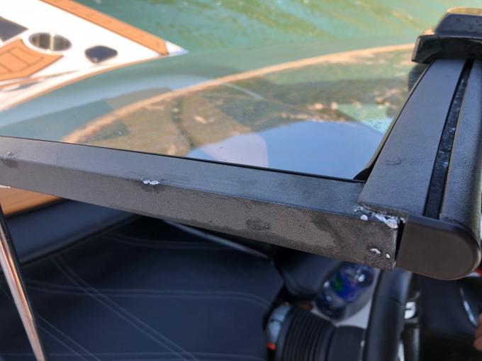

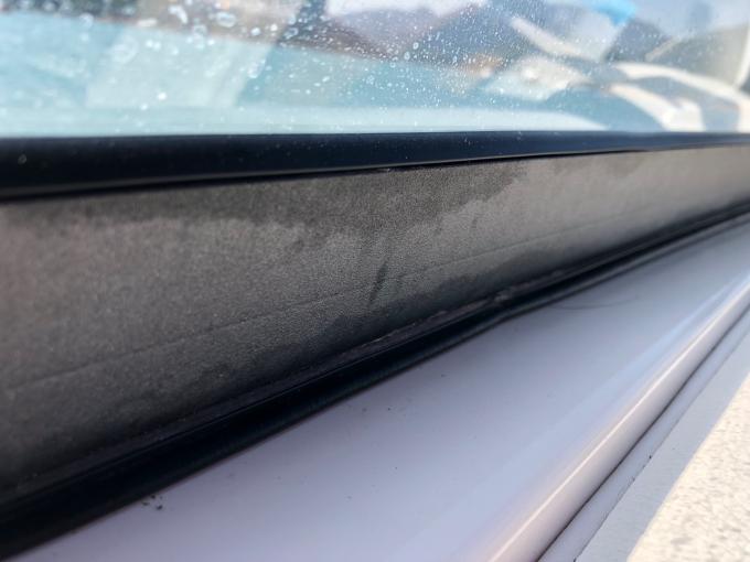

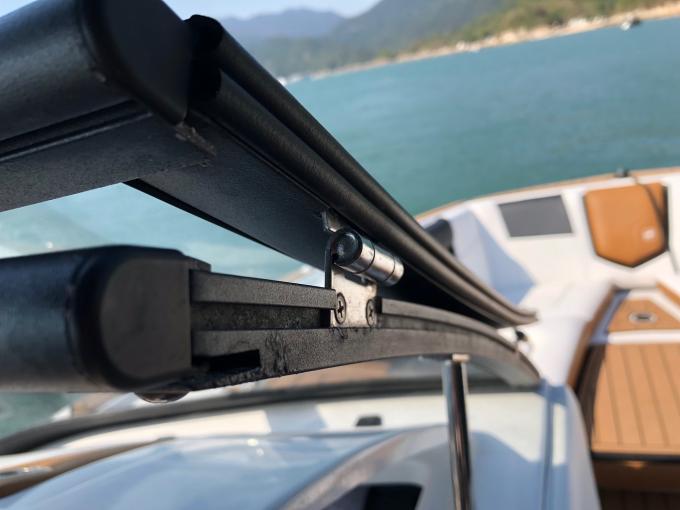

            The paint on the board racks on my 2014 210 started bubbling up like that and Nautique warrantied them.
            The claim was denied at first saying that the paint was chipping do to the boards hitting the paint.
            I took a video of the bubbling paint with no chipping or other marks and they turned the claim around and sent me new ones.
            I think you should talk to them.
            • ScooterMcgavin
              • 1478
              • 2014 SAN 210 TE
              I would think that's a legitimate warranty claim.
