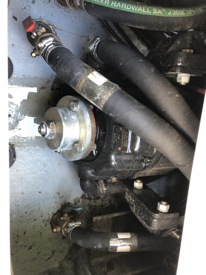

    A good friend of mine has a 2005 and I noticed that the vdrives/tranny are different...the 2005 seems to have a Walter vdrive which I’m familiar with
    Here’s a pic of mine:
    I’ve been researching and it seems to be the PCM power plus.
    I can only find a single dip stick for tranny/vdrive. And another one for the engine.
    Is there only 2 oils to be changed?? Rotella 15w40 in the engine and what do you guys use in the tranny??

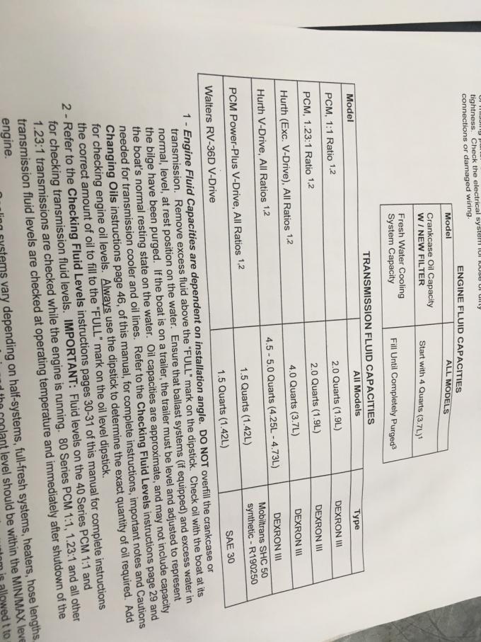

      You would have three oils/fluids. Engine, v-drive and transmission.
      I can’t remember the types for the other two however.
      • bandit628
        • Sep 2016
        • 318
        • Southern Illinois
        • Current-2012 SANTE 210 Past Boats 2000 Mastercraft
        ATF dex 3 is what my 210 tranny takes. Change every 100 hours. The vdrive does not require normal service.

            If it’s Dexron oil then I assume I have one of the top 3 listed trannies?
