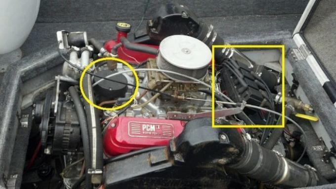

    My 1991 Ski Nautique has, after years of trouble-free operation, (500+ hrs) has developed a misfire at all speeds except idle. Sometimes the engine will quit, but will restart immediately. Research has led me to suspect the coil packs. Any way to test them? Should I consider retrofitting a new distributor system? Cost?

              That's normally a good idea but one of the concepts of the ProTec is no cap,points or rotor. A seemingly good first effort on engine management,the down side being no service parts or support.
              Click image for larger version  Name:	Protec_3.jpg Views:	1 Size:	46.0 KB ID:	572833

                Get rid of the pro tech, it’s crap! Mine was converted a long time ago and it runs great. It runs nearly as good as a new efi engine.

                  Thanks all. I've decided to junk the pro-tech and retrofit a DUI system. Now the shopping begins!

                    Go to skidim.com and they sell a kit to get rid of the pro tech.

                      While your Protec may have crapped the bed, when was the last time you did plugs/wires? I'd at least start there before dropping the money on a conversion, since you can easily re-use the plugs/wires if you swap to a dizzy (unless any of the coil packs look melted/deformed - in that case just convert it). If you do convert, you won't notice any difference in power, and may even notice an improvement since you're dealing with a carb. When mine craps out, I'm going to have to do the distributor and replace the TBI unit with a carb, which doubles the cost...
