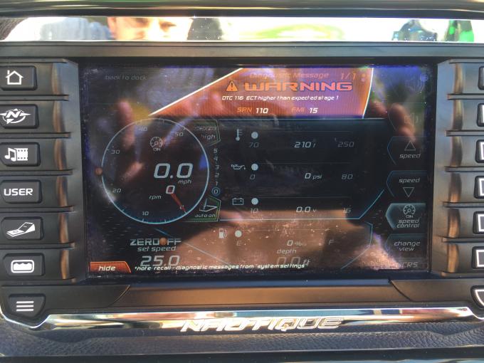

    While out today, the motor started overheating and shutting down. The oil level is good & the raw water strainer was not clogged. It seemed the engine coolent was low so we added maybe 10 oz of clean water after cooling down. This seemed to work and we made it back home with no further issues. The temperature dropped immediatly.

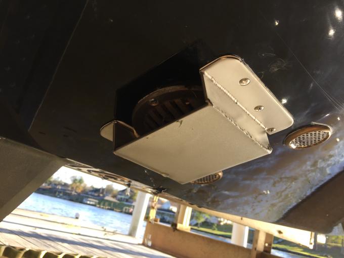

    After putting the boat on the lift, I inspected the intake on the bottom of the hull and saw a box covering it and it was full of debris; sticks, leaves etc. I’m coming from Mastercraft boats and have never seen the intake have a cover on it (this G is a new to me ‘13). Is this a standard factory install? I ride in a river and there will always be leaves, duck weed etc in the river. My first thought is to take it off but wanted some input if this cover is there for a reason.

    Yep standard OEM. Forces water in when at speed.
    with that being said... a few sticks in no way could block that unless they were all sorts of stuff cram packed in there.
    last time you changed/checked your impellor? What was it’s condition??

      Thanks dude! Yes, it was packed with small leaves, duck weed, small pieces of sticks etc. I wonder if anyone has taken it off. I’ll give the dealer a call when they open Tuesday.
      I just ordered a new impleller & have not inspected the current one; running out of daylight. I’m thinking it is combination of low collent, debris blockage and possibly the impeller.

        IIRC the ‘13s were shipped without that and people found they were running hot. That box was added to address the issue. Do you by chance have the 550? I think it was more of an issue with the 550s but could be remembering wrong.

            Mine does not have that box Rex you guys should come down and ride this weekend
