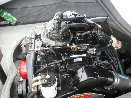

    We have a 2008 196 that was delivered new running solely on LPG, we are now looking at pricing on removing the LPG system and converting it back to petrol and looking for advice on the parts we will need to complete this.
    The injectors and fuel rails are in place but that is all, I would expect a tank, pump and filter but want to fit the correct parts.
    the injectors weren't used for the LPG system as it used the air inlet plenum as per a carburetted system.
    any help appreciated

ID:	573671 I assume the boat is in England or? I purchased a Nautique 206(2007) that was running on the same system and converted it back to petrol no problem. I sold the boat and the new owner made it a duel fuel boat switching between LPG & petrol.

        Thanks Andy, yes in the UK, where did you get the parts and what did you need to buy?

          Speak to Jason at Midland Nautiques... I got my parts from TV Ski but this firm does not exist anymore...Parts you can buy from Nautique Parts in the USA,but if you need a tank then ask Midland Nautiques first.... I had to take the injectors out and get them cleaned,if the fuel cell and low pressure pump and high pressure pumps are missing it will not be cheap to convert back... maybe it is better to stay with LPG...I only converted back to petrol because I was selling the boat here in Germany and the Germans are not great fans of LPG on boats...
          https://www.nautiqueparts.com/produc...-year-2003-on/
          https://www.nautiqueparts.com/product/fuel-control-cell-pcm-complete-was-part-ra080025-rb-superceded-by-part-ra080031/
